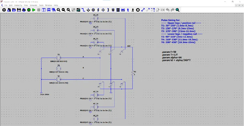

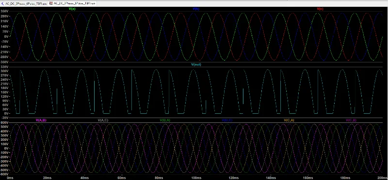

Hello, I'm trying to simulate a 3-phase, 6-pulse Thyristor Bridge Rectifier on LTspice, but I can't seem to get the results. Here is what I have so far. Could someone please guide me on this? Thank you!
Could you please attach a copy of your schematic filename.asc to a post. Do it by adding an extra extension, to make a text file called filename.asc.txt
You can do the same with the plot filename.plt extending it to filename.plt.txt
Then we can remove the .txt extensions, and run your simulation without the problems of poor picture quality.
The SCR you are using is not in my old LTspice library.
What model of SCR are you using ?
Where did you get the files for that SCR ?
I have not got it running yet.
Your gate bias was a problem. See attached.
