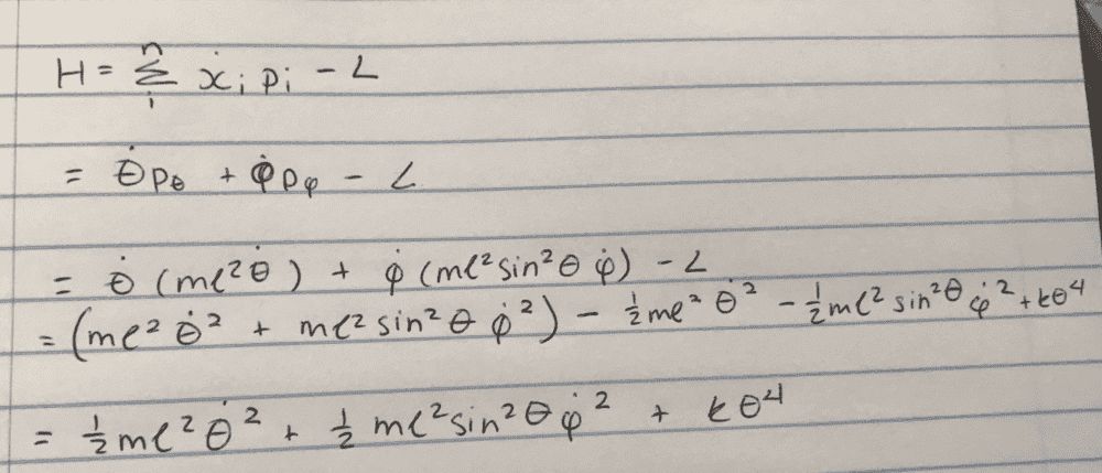

Convert to Hamiltonian
$$L(\theta,\dot{\theta},\phi,\dot{\phi}) = \frac12ml^2((\dot{\theta})^2 + (sin(\theta)^2)\dot{\phi}^2) + k\theta^4$$
Given the following
This is my attempt:
I am not understanding if the conserved quantities (like angular momentum about the z-axis) impacts my formulation of the Hamiltonian or is it irrelevant for the transformation. (EDIT: my last term below should be negative)
Irrelevant
Likes MyoPhilosopher
As @wrobel says, the fact that ##p_{\phi}## is conserved does not affect the formulation of ##H##. However, you should express ##H## in terms of the momenta ##p_{\theta}## and ##p_{\phi}## instead of the "velocities" ##\dot \theta## and ##\dot\phi##.
Likes JD_PM, etotheipi and MyoPhilosopher
Hint: By definition the Hamiltonian , in general, has to be a function of momentum ##p## and general coordinate ##q##.
In your problem you need to get ##H(p_{\phi},p_{\theta}, \phi, \theta)##
