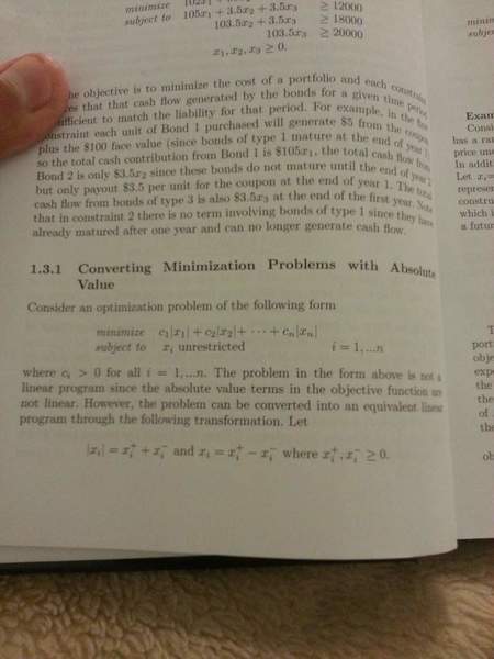

Here is a pretext from my textbook that shows how to do it a different way

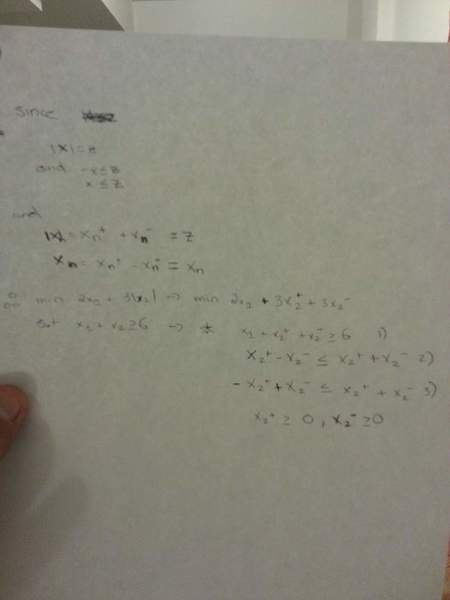

After a while of staring at it ,I gave it a try
What do you guys think?

I think there is something wrong with the problem statement: it has ##x_1## and ##x_2## in the objective but ##x_1## and ##x_3## in the constraint.
Mod note: This is now fixed.[/color]
As written, the problem does not have a finite solution, since we can have ##x_1 \rightarrow -\infty##, ##x_3 = 6 - x_1 \rightarrow +\infty## and ##x_2 = 0##. If you really intend to have ##x_1 \geq 0## you need to say so.
In any case, you need only one constraint, not three. Basically, it is one of the standard methods for such problems to just replace ##x_2## by ##x_2^+ - x_2^-## (with ##x_2^+, x_2^- \geq 0##) and to write ##x_2^+ + x_2^-## in place of ##|x_2|## in the objective.

Anyways , you the way you have said I already know how to do. But the reason I am confused is that the question asks that the aforementioned observation be used in answering the question.

There are two *different* ways of handling such problems, and you have mixed them up. For problems in which |x| appears only in the objective, and with a coefficient c > 0, we can:
(1) Replace ##x## in the constraints by ##x^+ - x^-## and ##|x|## by ##x^+ + x^-## in the objective; or
(2) keep x unchanged in the constraints, replace |x| in the objective by a new variable z, and add two constraints z ≥ x and z ≥ -x.
