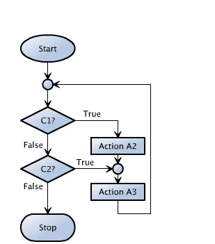

Why exactly can't it be converted into pseudo-code then? I'm seeing the race condition and how the program can fail but I am not seeing how it cannot be converted into pseudo-code.
For example:
Do A1=0
Do A1=1
If A1==1
For example:
Do A1=0
Do A1=1
If A1==1
somethingClever

It can be converted into psuedo code, but you need a convention on how to describe parallel threads with pseudo code, and operators that can pend on actions (including spawning and termination) between threads.sandy.bridge said:Why exactly can't it be converted into pseudo-code then?

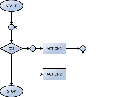

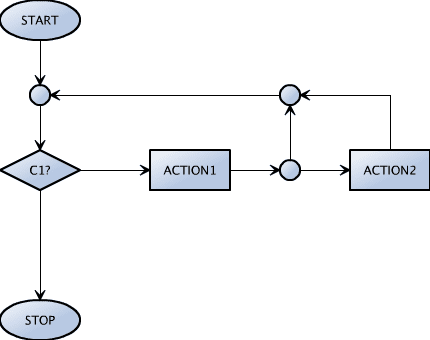

Well, I emailed my professor and he essentially shot down all this work regarding this question. I do, however, have a hint: what implicit rules are there regarding performing the actions of a block, and is there a way to create a flow chart that violates one or more of these said rules.
Since blocks go from top to bottom in pseudo-code, what if we did something like this:

I would assume that the actions of a block are described as text within the block, and in that case why couldn't similar text be used in pseudocode?sandy.bridge said:Well, I emailed my professor and he essentially shot down all this work regarding this question. I do, however, have a hint: what implicit rules are there regarding performing the actions of a block, and is there a way to create a flow chart that violates one or more of these said rules.
If the point is that a single block could have multiple arrows going out of the block, you could duplicate this in pseudocode using a goto with an arrary of labels.
update - I just noticed your figure, but already covered this case, you just need an array of labels to use with a goto. In this case one label would go to "action2", the other would go directly back to "C1?" . Both are bending the rules in the same manner.
