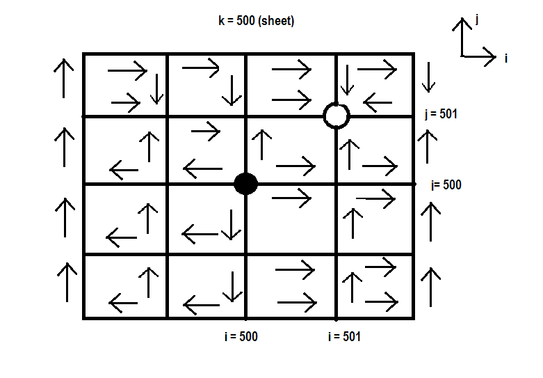

Write a program to find the equivalent resistance between two opposite corners within a grid of "infinite size" with resistors between each point.
So basically we have an infinite cube made up of cubes with 1 ohm resistors between each node.
Kirkoff's laws
Really what I'm having problems with is defining the direction of the current in a way that is consistent and allows every point a path from V+ to V-=0
I'm using a 1001x1001x1001 array that will hold the coefficients for each kirkoffs current law at each point. I am setting 500,500, 500 = V+ and 501,501,501 = 0 V (so it's symmetric about the central cube of resistors).
What I'm doing so far,I have k=500 and drew a plane and sketched out the current paths.
I have for the current direction: (it won't let me put pseudocode as the language)

I'm measuring the equivalent resistance between 500,500,500 and 501,501,501
This feels like a bit overkill, so my question, is there a better way to write this?
Really all I need is for every point to have a complete path to 501,501,501 and a complete path from 500,500,500 to that point. Additionally, I need 500,500,500 to send out current in all directions and 501,501,501 to take current from all directions.
In the picture, the arrows indicate the current flow, the solid circle indicates that the point is V+ and the empty circle indicates that V- = 0 is in the adjacent plane.

Kirchhoff.
You won't find an analytic solution with a program, so you have to use a numerical simulation. In this case you can simplify the program a lot with an iterative approach.
In equilibrium, can you find the voltage at a node (apart from the two fixed ones) if you know the voltages of the nodes around it? Just use some starting grid voltages, then update voltages iteratively.

Your grid in the problem statement is infinite. Even if you can find an analytic solution for the 10013 cube (which is theoretically possible), that is not an analytic solution for the full problem.
Did you find the equation I was mentioning in post 2? It gives you a single, easy equation for each grid point.
I didn't. Also, we're only supposed to be getting an approximation.
Are you suggesting that I use the symmetry of the cube to draw equipotential lines and work my way out from the two fixed points?

No, that won't help, you just know one equipotential area.
I suggest to do what I suggested in post 2. Once you have that, the problem should be easy. In 2D, it is literally just one minute of work with Excel (old example), in 3D it is a few minutes of coding and a bit more for running (I would limit the grid to something like (101)3 entries for reasonable computing times).
Ok so I got it finished. I did it both ways, the averaging method, and also with linalg.tensorsolve. The averaging gives a result of about .24 ohms with 150 averages (about .23 with 50) and with the tensor algebra, I get R equivalent of about .21.

So I just realized this, but I had set l=3, meaning a 3x3x3 cube. For this value I get .219, which is consistent with the averaging method. However, when I change it to anything higher, I get something of the order of -16... which is not consistent with the averaging method. Every single point is spiking to 25 volts (I used a fixed current flowing out of V+ and into V- and allowed the voltages to vary dynamically). My guess would be that I have a mistake in my coefficients, and that "current is being stored" in the nodes.
Any ideas for this last one? I can answer questions about the code if you have any.
avg = total/6
Not always 6, unless you fix the voltage at the border to 0 (but then you could save all the casework). Setting the border to a fixed 2.5 V should work, if you use the array borders then you don't need all the subcases for the averaging process. Just skip the borders in the update.
You are overwriting nodes while you are still processing neighbor nodes. That can lead to unexpected effects. A copy of the array should work better.
No change in the result, but probably easier: instead of the if/elseif condition in the innermost loop, you can overwrite the nodes (if you work with a copy: see above) and end an iteration by setting the values again.
I did fix the borders to zero, or beyond the borders, I should say. I'm treating them as infinitely far away, so the voltage between that and ground is zero.
I didn't think about the fact that I was overwriting values. Thanks for that.
You should set them to the average of the two "input" nodes - that is the approximate voltage a truly infinite grid would have far away due to symmetry. There is nothing special about zero.
