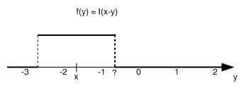

But x-y isn't always in (-1,1). Here's what you need to do. Mark off a horizontal y-axis (not x axis) between -3 and 3. Mark a point called x at about -1.5. Then highlight the interval that goes one unit each direction of your point x. These will be the points where I(x-y) = 1 as y varies from -1 to 1. So draw a graph of this I(x-y), it is one on that interval and 0 elsewhere. Now what happens if you integrate that function you have drawn from y = -1 to 1? What your picture looks like depends on where x is.

I don't want you to think x = -1.5, just be a point near there. Here's what your picture should look like:
x is an arbitrary point, and f(y) = I(x-y) is a translated indicator function that is 1 for a distance of 1 each direction from x and 0 elsewhere.
Your problem is to calculate the integral:
\int_{-1}^{1} I(x-y)\ dy
Note that f(y) is mostly zero on (-1,1) and you need to figure out the value of ? to do the integral. It depends on x. You need to see what x this picture works for and see if you need a different picture if x is farther to the right.

Yes. You get zero for the function on the rest of the interval don't you? You are integrating the function in the picture after all.
So, in the picture, what is ? in terms of x? Then do the integral and tell me what you get. It will be some function of x.
Once you figure that out your next problem is to figure out for what x the answer you get works. Think about sliding the picture left and right corresponding to different values of x and what it does to the limits of integration. And you should also be able to see why x outside of (-2,2) gives zero for the integral.

Yeah it's being very slow with me too. Erm would ?=x+1 so the integral is equal to (x+2)?

Yes, but that doesn't work for all x. Look at what happens as x moves to the right.

Look at the above graph from an earlier post. In one of your posts you figured out that ? = x+1. So OK, what do you get if you integrate that function in that picture from -1 to 1. Actually do the integral.
2. I think so, is it because when x < 0 the overlap is given by 2+x and when x<0 the overlap is 2-x?
It isn't "overlap" we are after, it is the value of the integral. Draw another picture with x > 0 and do the corresponding integral once you figure out the interval. That is the only way you will understand where the 2+x and 2-x actually come from.

1. so the integral would be between -1 and x+1 of 1dy which would be (x+1)-(-1)=x+2?
2.If x>0 then the integral is between 1 and x-1 of 1dy which would be (x-1)-(1)=x-2
henry22 said:
1. so the integral would be between -1 and x+1 of 1dy which would be (x+1)-(-1)=x+2?2.If x>0 then the integral is between 1 and x-1 of 1dy which would be (x-1)-(1)=x-2
You have the limits reversed on the second one but other than that:
Yes! Ta-Daaa! :biggrin:
You have now successfully actually calculated a convolution integral. Now that you have done that you might enjoy an animated picture of a convolution, albeit with two different functions. But it is the same idea. The shaded area represents the value of the integral. Look here:

So can I just check I have understood it. So to find the integral I need to say how the limits change depending on whether x>0 or x<0 and then calculate the integral for each case?
That's what it amounts to. Note that I did edit that last post; you still have a minor error that I didn't notice my last post.
Thank for all your help, it's very much appreciated!
