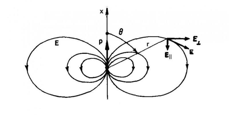

Hi everybody! I might have solved that homework but I struggle to properly understand some steps, especially concerning the gradient and partial differentiation:
The potential Φ(r) of an electric dipole located at the origin of a coordinate system is given by:
[tex] \phi (\vec{r}) = \frac{1}{4 \pi \varepsilon_0} \frac{\vec{p} \cdot \vec{r}}{|\vec{r}|^3}[/tex]
where p is the electric dipole moment and r is the vector from the dipole to the point from which the potential is searched (see attached pic). The electric dipole moment is oriented in the x-direction.
Calculate from the general relation E = -∇φ the coordinates Ex, Ey, Ez of the electric field vector E.
[tex] \vec{E} = -\nabla \phi (\vec{r})[/tex]
To begin with, I imagine that what they mean with "coordinates of the vector" is basically equivalent to "components", right? Here is how I started:
[tex] \vec{E} = -\nabla \phi (\vec{r}) = -(\frac{\partial \phi (\vec{r})}{\partial r_x} \vec{e_x} + \frac{\partial \phi (\vec{r})}{\partial r_y} \vec{e_y} + \frac{\partial \phi (\vec{r})}{\partial r_z} \vec{e_z}) \\<br /> \implies E_j = -\frac{\partial \phi (\vec{r})}{\partial r_j} \vec{e_j}[/tex]
Is that correct? My problem here is that I never really learned how to do a gradient (I guess it's time to learn!). So I've done the following steps with some help from the internet.

Then I know that py = 0, but I think I cannot say what pz is equal too since the problem only says that p goes in the direction of the x-axis.
[tex] E_x = \frac{3 p_x r_x}{4 \pi \varepsilon_0 r^5} \vec{e_x} \\<br /> E_y = 0 \\<br /> E_z = \frac{3 p_z r_z}{4 \pi \varepsilon_0 r^5} \vec{e_z} \\[/tex]
I'm afraid this might be all wrong... :/ I didn't use the angle θ shown on the picture and that Ey = 0 doesn't really give me confidence. Maybe there is an easier way to solve that? What do you guys think?Thanks a lot in advance for your answers.Julien.

I think you're on the right track. However, it might be helpful to convince yourself of a few basic facts about gradients:
  • [itex]\nabla (\vec{p} \cdot \vec{r}) = \vec{p}[/itex] (if [itex]\vec{p}[/itex] is a constant vector)
  • [itex]\nabla f(r) = \frac{df}{dr} \hat{r}[/itex] (where [itex]\hat{r}[/itex] is a unit vector in the direction [itex]\vec{r}[/itex])
  • [itex]\nabla \frac{\vec{p} \cdot \vec{r}}{r^3} = \frac{\nabla (\vec{p} \cdot \vec{r})}{r^3} +(\vec{p} \cdot \vec{r})(\nabla \frac{1}{r^3})[/itex]

There is a problem.
You have a term with the product ##\ \vec{p}\, \vec{e}_j \ ##.
As steven said, ##\ \nabla (\vec{p} \cdot \vec{r}) = \vec{p} \,,\ ## so the j component of this gradient is simply ##\ p_j\ ##.
Also, you mishandled ##\ \vec{p}\cdot\vec r\ ##. It disappeared after the second line.
@SammyS hi Sammy and thanks for your answer. Then is that correct:
[tex] E_j = - \frac{1}{4 \pi \varepsilon_0 r^3} (p_j + \vec{p} \cdot \vec{r} \frac{3 r_j}{r^2}) \vec{e_j}[/tex]
? If yes, can it be simplified? This is all pretty confusing and ugly looking.Julien.

Looks good.
That's for ##\ \vec p \ ## in an arbitrary direction. The statement of the problem has ##\ \vec p \ ## in the x-direction.

@SammyS Thanks a lot! Then, if I understood correctly:
[tex] E_j = - \frac{1}{4 \pi \varepsilon_0 r^3} ( p_j + p_x \cdot r_x \frac{3 r_j}{r^2}) \vec{e_j} \\<br /> \implies E_x = - \frac{p_x}{4 \pi \varepsilon_0 r^3} (1 + \frac{3 r_x^2}{r^2}) \vec{e_x} \\<br /> \mbox{and } E_y = - \frac{1}{4 \pi \varepsilon_0 r^3} (p_x \cdot r_x \frac{3 r_y}{r^2}) \vec{e_y} \\<br /> \mbox{and } E_z = - \frac{1}{4 \pi \varepsilon_0 r^3} (p_z + p_x \cdot r_x \frac{3 r_z}{r^2}) \vec{e_z} \\[/tex]
Is that correct? I am still unsure whether pz = 0 or not. What do you think?
Thanks a lot for your precious help :)Julien.
Both ##\ p_y \text{ and } p_z \ ## are zero.

##(\vec p\cdot \vec r) ## is a scalar, it dos not have x, y, z components.
Accordingly, the electric field vector is $$\vec E = - \frac{1}{4 \pi \varepsilon_0 r^3} (\vec p +( \vec{p} \cdot \vec{r}) \frac{3 \vec r}{r^2}) $$.
If a function depends only on ##\vec r## you get the gradient easier if you formally differentiate with respect to ##\vec r##.
Rewriting ##(\vec r)^2=r^2##
$$\vec E = -\frac{1}{4 \pi \varepsilon_0} \frac{\vec p r^2 -3 (\vec p \cdot \vec r ) \vec r}{r^5}$$
This is equivalent to Julien's for the case ## \ \vec p = p_x \, \hat e_x \ .##

JulienB said:
Are you saying my previous result was wrong, or are you proposing an alternative way to solve it, possibly more efficiently?Julien.
Your end result was correct, I only wanted to show an alternative method to get the gradient of a function.
There was a mistake in your first post
$$E_j = \frac{-1}{4 \pi \varepsilon_0} \frac{\partial}{\partial r_j} (\frac{p_x \cdot r_x + p_y \cdot r_y + p_z \cdot r_z}{(r_x + r_y + r_z)^{\frac{3}{2}}}) \vec{e_j}$$
There should be squares of the coordinates in the denominator. I don't see why you write the coordinates x, y, z as rx, ry, rz. As for the dot product ##(\vec p \cdot \vec r )## I might have misread something.
