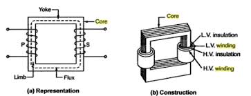

you can refer the below image for reference. I have mentioned flux and flux density because from these two we can find cross sectional area and with the formula i mentioned above we can find the volume of core.
Is this the right method to get value of volume of core?
  • Two diagrams of a single-phase transformer: (a) Representation showing P and S windings on a rectangular core with labelled Yoke, Limb, Core and Flux path; (b) Construction showing the laminated core with L.V. and H.V. windings and insulation.
B and flux depend on externally applied electrical excitation and have nothing to do with core volume or other geometrical aspects.
