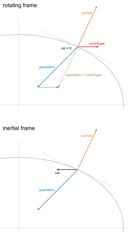

The plumb-line on a spinning planet is along the effective gravity (gravity + centrifugal). If your thrust exactly cancels that, then the mass obviously won't move relative to the planet, regardless what its shape is.
  • #49
Makes sense. Simply, I used the wrong example, in using "thrust vectored to plumb". we should have stayed with the ball rolling, but i wanted to remove friction and local surface shape characteristics. So basically, with thrust vectoring to plumb of this hypothetical object, it will not move when placed anywhere on the Geoid.
thanks.

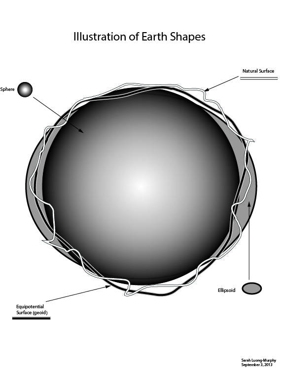

This makes me think of something related to this discussion. could the gravitational vectors around the Geoid create areas of parallels plumb lines, giving wide surface areas on the Earth to appear flat. From some drawings/simulations/calculations, it seems that there could be areas where water (lakes.ocean) would appear to be measured flat.straight or that you could see further than you could calculate you should see based on a spheroid if so, it might explain some of the "flat earther" communities observations and tests (however uncontrolled as they may be)
jbriggs444 said:
Plumb line -- that means that the force is at right angles to the equipotential surface. So the mass stays in place on the equipotential surface above the oblate ellipsoid Earth.

I wouldn't try to explain the Flat Earthers except in a psychiatry forum, not in a physics forum.
Your geometry is correct, but the FEers ignore so much obvious evidence that I can never fully believe that any are serious.
  • #52
Yes, I believe that a ring-shaped mass concentration could allow a region of flatness at its center.
However, In the absence of a peer-reviewed flat earther result, there is nothing in that regard to discuss here.

Now that's funny! I know, they see flat, so therefore its flat. I think they are serious too. They had one observation on the salton see of a guy holding a mirror (tipping up and down) and then a person on the opposing shore at 19miles away who saw the reflection and caught it on camera. refraction didn't seem like it could account for 150+ft of something being hidden by calculated curve... so , maybe it was one of the "flat spots" on the earth. ;)
What "ring shaped" concentration? if I'm reading the chart correctly , would that be one side view where the south east corner has a relatively gravitationaly flat area a few 1000 miles north to south?
Lay a steel hoop on the ground with a radius of a few hundred meters. Adjust the thickness of the hoop until, for a few meters in the middle, you have the local "vertical" lined up all nice and parallel.
Good luck detecting the difference between this and no hoop at all.

I see what you are talking about. that wasn't what I was asking or indicating... a hoop, could be analogous to the horizon , which always will be at the same angle from a vertical center "z" non 0 axis point. vs a truly flat surface. The difference would be the angle from that axis that the horizon/hoop would lie. If there was an anomalous
area of equipotential gravity , where plumb lines were all vertical or possibly angled outward, the water would appear and be flat and maybe even concave in some regions, right?

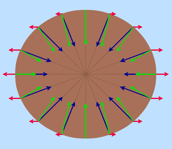

  • #59
Jeff Root said:
The Earth's shape is an oblate spheroid, where every point on the surface
is perfectly level. So unlike a sphere, it is not gravitationally downhill to
the equator. Gravity is always perpendicular to the surface.
Not gravity is perpendicular to the surface, but the vector sum for gravity and centrifugal force in the geoid's rotating frame.
Jeff Root said:
Doing the same thing on an oblate spheroid results in an ellipse, centered on the center of the spheroid. The point mass will coast from the 45th parallel toward the equator, cross the equator, reach the opposite 45th parallel, and then coast back toward the equator again.
No. Your step from sphere to geoid is wrong. Here is what happens on the geoid :
In the rotating frame of the geoid all forces (gravity, centrifugal, normal) balance and the mass remains at rest. That defines a geoid.
In the inertial frame, there is no centrifugal force, and thus the forces are not balanced. The resultant force points perpendicularly towards the axis (opposite to the now missing centrifugal force), not towards the center. Thus the mass moves on a circle around the axis at constant latitude, not on an ellipse around the center.
