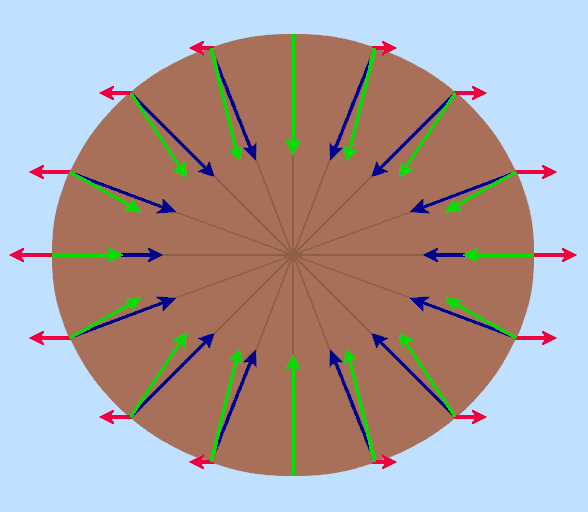

Yes. As FactChecker said, that is what I meant, and as you replied,A.T. said:Not gravity is perpendicular to the surface, but the vector sum
for gravity and centrifugal force in the geoid's rotating frame.
I should have noticed and kept them separate. I just didn't think
of doing that.
I was trying to avoid discussing forces in different reference frames.A.T. said:No. Your step from sphere to geoid is wrong. Here is what happens
on the geoid :
In the rotating frame of the geoid all forces (gravity, centrifugal, normal)
balance and the mass remains at rest. That defines a geoid.
In the inertial frame, there is no centrifugal force, and thus the forces
are not balanced. The resultant force points perpendicularly towards the
axis (opposite to the now missing centrifugal force), not towards the
center. Thus the mass moves on a circle around the axis at constant
latitude, not on an ellipse around the center.
My argument is that an object on Earth's surface, moving with Earth's
surface, and suddenly released from all friction,
(1) will move in a straight line away from the point of release,
(2) the straight line passes over locations progressively closer to
the equator than the point of release, and
(3) the straight line is bent by Earth's gravity into a path approximating
a great circle, so that the object slides along the surface.
Since the Earth is an oblate spheroid rather than a sphere, the path is
a great ellipse instead of a great circle. It is an ellipse for a different
reason than why a satellite in orbit follows an elliptical path, and in fact
is sort of opposite in some ways, but they are similar in other ways,
such as losing and gaining speed as they rise and fall. (The surface of
the Earth moves to the east fastest at the equator, but the object sliding
frictionlessly across the surface slows from its already-lower initial speed
as it approaches the equator and rises out of the gravity field, so the
Earth will be moving rapidly to the east underneath it.)
My argument has the serious shortcoming that it doesn't say anything
about how the initial speed of the object relates to the path it takes.
If the argument is wrong, that is probably where it fails. My argument
is mostly just geometric.
-- Jeff, in Minneapolis

Repeating that claim doesn't make it less wrong. The issue was explained several times in this thread:Jeff Root said:Since the Earth is an oblate spheroid rather than a sphere, the path is a great ellipse instead of a great circle.
The geoid is per definition an equipotential surface in its rest frame. So a mass placed at rest relative to the surface of a frictionless geoid will not move relative to it, and thus cannot move to the equator.

On a sphere Newtonian gravity is perpendicular to the surface everywhere. On the geoid the surface is oriented differently between the poles and equator, and Newtonian gravity has a component that is parallel to the local surface, and points towards the pole.Jeff Root said:So my question to you is where the gravitational force comes
from that causes a mass on the frictionless surface to turn
toward the nearer pole and stay at the latitude it started at,
instead of continuing on in the direction it was moving when
the friction was removed.
I explained the forces in both reference frames in post #59.

There is no mysterious gravitational force here. There is simply the gravitational force, the angle of the surface and the motion of the point on that surface. There are two reasonable ways of analyzing the situation.Jeff Root said:Yes, that is why I asked you where this mysterious gravity force comes
from.
1. From the inertial frame: The object is in motion. It is following a circular path that moves with a point on the Earth's surface. The gravitational force is toward the Earth's center. The centripetal acceleration is toward the Earth's rotational axis. The two are not in parallel directions. However, the Earth's surface is sloped just right so that the resultant of the upward normal force and the downward gravitational force accounts for the centripetal acceleration.
2. From the rotating frame: The object is at rest. There is no Coriolis force. There is still a gravitational force toward the Earth's center. There is a centifugal force outward from the Earth's axis. The two are not parallel. However, the Earth's surface is sloped just right so that the resultant of the upward normal force, the downward gravitational force and the outward centrifugal force is zero.
The effect on gravitation of the equatorial bulge is nearly negligible. The bulge is not caused by the bulge. It is caused by centrifugal force. In any case, the shape of the geoid is, by definition, enough to cancel any net force along its surface, as measured in the rotating frame.Jeff Root said:On the surface of the geoid, the gravitational force produced by
the equatorial bulge is toward the equator, not toward the poles.
If you hang a plumb line from a point at a temperate latitude, it will not point directly down toward the Earth's center. It will, however, be perpendicular to the geoid.

Look up the definition of a geoid:Jeff Root said:The opposite of what you said.
https://en.wikipedia.org/wiki/Geoid
It's an equipotential surface in its rest frame. So if you place a friction-less mass on the geoid at rest relative to geoid, the mass will stay at rest relative to the geoid. Therefore the mass cannot change latitude, and move towards the equator.
What about this simple and straightforward explanation is confusing you?

I don't see it. The net gravitational force is toward theA.T. said:It comes from the orientation of the geoid surfaceJeff Root said:That's what I asked you to explain. What is this mysterious
component of Newtonian gravity that is "parallel to the local
surface"? Where does it come from?
relative to Newtonian gravitation.
opposite hemisphere. That is the opposite of what you are
claiming.
The diagram shows a cross-section through the Earth with the
axis of rotation vertical and the equator horizontal. The blue
arrows are vectors of gravitational strength at the surface.
Red arrows are vectors of "centrifugal force". Green arrows are
vectors of the net downward force. This net force is everywhere
perpendicular to the surface, so the surface is "level". There
is no gravitational force parallel to the local surface. No
force that can make a loose, frictionless object travel around
the nearest pole instead of around Earth's center.
Notice that the green vectors point toward locations on the axis
in the opposite hemisphere. The net force is deviated away from
Earth's center toward the equator, not toward the nearer pole.

You forgot to draw the normal force. If you are going to do a free body diagram, draw all the forces.Jeff Root said:

Jeff Root said:
The blue arrows are Newtonian gravitation, and they are not perpendicular to the surface, so they do have a component parallel to the local surface.
If you want to talk about net force and movement, you have to state the reference frame. See posts #59 and #68 on how to do this.
The net force in either frame includes the normal force from the surface, which is missing in your diagram.
