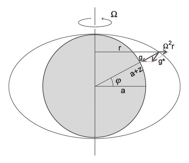

Earth surface is a (nearly) equipotential surface. Since centrifugal effect merely adds to effective potential, it makes no contribution to the weather.

Centrifugal force will always provide an acceleration directly towards the equator (and partly up also). The magnitude of the acceleration depends only on the latitude, not on the speed of the wind.
Coriolis force will always provide an acceleration perpendicular to the wind (and purely horizontal) … so it makes the wind go in a circle. The magnitude of the acceleration is proportional to the speed of the wind and the sine of the latitude.
Obviously, both these forces are connected with the rotation of the Earth.
No, it will never, ever do that. Centrifugal force does not affect the winds.
There is so much wrong in this thread that it's mildly amusing, but Re: centrifugal force, you can calculate it if you like using standard formulas and you'll find that you weigh about 0.35% less at the equator than you do at the pole, neglecting the oblate nature of the Earth's surface (which makes you weight even a bit less at the equator, total variation is around 0.5%).
The centrifugal force is not directed towards the equator, I don't know where this idea comes from but at least two people seem to think this is true.
It's a headshaking moment when someone claims on a physics forum that they are correct and Feynman is wrong. OP might head to Africa where the air has gone, and carefully study what Feynman had to say. :smile:
