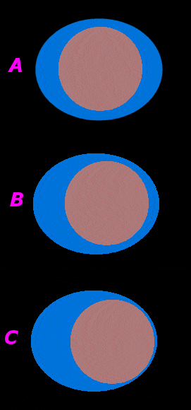

Hi. Some books explain tides as a result of the gravitational pull of the moon with an exaggerated drawing like A below.
It seems to me that A is not correct, but B and C are more like it. Because the moon pulls all water towards it, not just one side.
Which is correct and WHY?

Let me just rephrase the question: Is the radius of the ocean the same on both sides and WHY?

I do not see the answer to the following below.
Having now read the whole part about that diagram, it does not give a reason why the equipotential surface of the tidal force should have two bulges. Let alone two bulges of equal height from the center.
I agree that the wikipedia article about 'tide' does not offer explanation for the fact that planetary tidal effects give rise to two tidal bulges, on opposite sides of the planet.
However, there is also the wikipedia article about 'tidal force'.
The page with the two-panel diagram http://en.wikipedia.org/wiki/File:Tidal-forces.png" specifically explains the dual bulge.
