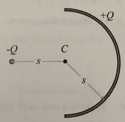

Problem # 4:[/B]
A thin semicircular rod has a total charge +Q uniformly distributed along it. A negative point charge -Q is placed as shown. A test charge +q is placed at point C. (Point C is equidistant from -Q and from all points on the rod.)
http://imgur.com/AeVfddb
Let FP and FR represent the force on the test Charge due to the point charge and the rod respectively.

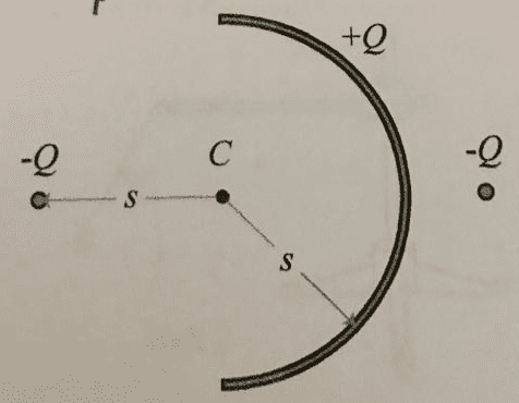

Part C:
A second negative point charge -Q is placed as shown.
http://imgur.com/eYEOkPc
Is the magnitude of the net electric force on +q greater than, less than, or equal to the magnitude of the net electric force on +q in part b? Explain.

So I solved part b (hopefully correct), but I want to say that the magnitude of the net electric force on +q will be less than the one found in part b since the -Q charges would cancel out as they are the same distance thus same magnitude, but opposite directions. However, I am confused on how the semicircular rod affects this as it is right there between it and the -Q charge.
