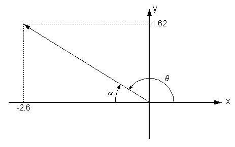

Okay. Since you've got the x and y components, I take it that you're looking for a way to calculate an appropriate angle associated with the net force vector?
First add all the like-components; sum up the x-components and sum up the y-components for all the contributing forces.
The usual point of reference is the positive x-axis, with angles measured counterclockwise from there being deemed positive. Taking the vector that you've calculated for the force of q2 on q1 as an example you can do the following:
You can look at your components and determine in which quadrant the vector lies. In this case you've got (scaled for ease of use) x = -2.6 and y = 1.62. So it lies in the 2nd quadrant. If you've got a calculator with an atan2 function you can calculate the angle right from those values. Otherwise you'll have to take a bit of care with the standard trig functions.
Have a look at the attached figure.
You can calculate the angle α using the standard atan function with the absolute values of the x and y components: α = atan(|y|/|x|) = atan(1.62/2.6), then subtract it from π to give θ. Or for the second quadrant you might use acos to calculate it directly from the component values: θ = acos(x/sqrt(x2 + y2)).

Thank you again gneill. I have now arrived at the same answer as the OP. I was a little confused with the quadrants but I figured it out.
