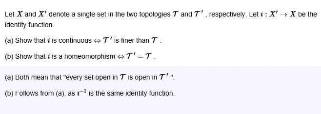

let X and X' be two single sets in two topologies T and T' respectively.A standard textbook asks to show that if identity function i:X' →X is continuous then T' is finer than T.Is the example below a valid counter example to this argument?
3. The example goes like this .Consider γ={1,2,3,4,5} and T={∅,γ,{1,2},{1},{3},{1,2,3},{1,3}} and T'={∅,γ,{1},{1,4}}.X={1,2} and X'={1}.so the subspace topology on X due to T i.e Tx={∅,X,{1}} and T'x'={∅,X'}.It is obvious that inverse of each open element in X' is open in X, but T' is not finer than T.

Is i:X' →X continuous?
But usually the identity function is defined from a space to itself, or at least ##X' \subset X ##.

May I repeat the question: is i:X' →X continuous?
In post #1 you write "It is obvious that inverse of each open element in X' is open in X". But what you have to look at are the inverses of open elements in X.

Ok, you fixed the OP, it was a typo.
But you are dealing here with two different sets, ##X' \subset X##. How do you define "finer" in that case? Obviously ##\{1,2\}## can't be in T', as 2 isn't an element of ##X'##.
Could you post the precise question from the book?
What is generally claimed is that if you have a set Y with two topologies, S and S', then the identity map
##I: Y,S \to Y,S'## is continuous if and only if ##S' \subseteq S##.
I you want to extend this to identity maps between real subsets ##X' \subset X##, then you will have to compare the topology on X' with the topology induced on X' by the topology on X.
the question goes like this exactly as follows." let X and X' denote two single set in topologies T and T', respectively.let i:X' →X be the identity function.
p: i is continuous.
q: T' is finer than T. "

your suggestion " But you are dealing here with two different sets, X&X' X′⊂X. How do you define "finer" in that case? " seems to suggest that you are considering the notion of " fineness" between Tx and T'x' rather than doing the same between T and T' as the question literally suggests.and for your reference the question can be found in the following link "http://dbfin.com/topology/munkres/chapter-2/section-18-continuous-functions/problem-3-solution/"

The question in your link is: "Let X and X' denote a single set in the two topologies ..."
Not two sets as you write.
As sets, X=X', so your counterexample is moot.

Yes, you have two sets. The books talks about one set (with two topologies).
For reference, this is the full question in your link:
So no, you don't have a valid counterexample to the correct claim in this exercise.

The book asks you to consider i: X' → X. In your case, as sets, X=X'={1,2,3,4,5}
Now, you can check whether the function i is continuous or not with the topologies T' on X' and T on X.
Nowhere does the exercise refer to an "identity function" between two different sets.

f could be an inclusion, when A is a subset of B. I guess one could call that the identity function.
But in this case, in this exercise, it is clearly stated that X and X' denote a single set (with two topologies).

finally got it.i thought what the book meant was that X and X' are just two single set members of T and T'.But now I feel like your explanation is correct as the book is saying to consider a particular set as two different set in the context of two different topologies.i feel satisfied with your explanation.ironically the problem that got me into this mess is my micronemesis i.e english.anyway appreciate your genuineness and benignness
