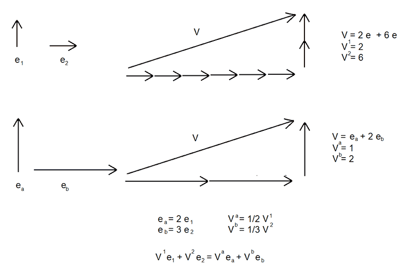

It's just a convention, but whether the index is raised or lowered tells how the object transforms under coordinate changes. Here's a simple illustration:
At the top, we have a two-vector basis, ##e_1## and ##e_2##. We have a vector ##V## that can be written in terms of that basis as:
##V = 2 e_1 + 6 e_2##
In terms of the basis ##e_1, e_2##, we can write the components of ##V## as:
##V^1 = 2##, ##V^2 = 6##
At the bottom, we have a different basis, ##e_a = 2 e_1## and ##e_b = 3 e_2##. In terms of this basis:
##V^a = 1##, ##V^b = 2##
So when the basis vectors get bigger, the components get smaller, so that the combination ##V^\mu e_\mu## remains constant.
Whether the coordinate is raised or lowered tells how the object changes. (Assuming that we're dealing with vectors or tensors or their components)

Thanks for the reply. I have a few more questions. If this isn't the proper forum, please tell me; and I'll create a new thread.
So, I'd like to be sure I understand: The second representation of V that you have there is a covariant representation because the basis, let's call it basis two, is a covariant one, right? However, it just so happens that the component, which has another basis, let's call it basis one, incorporated into it, has a raised index, as opposed to a lower one because the component contravaries to basis two?
