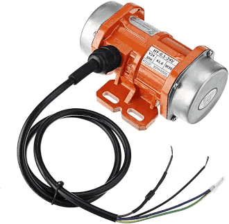

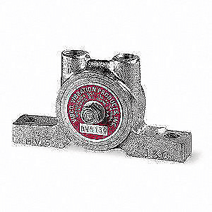

You can buy relatively inexpensive things that vibrate that have electric or pneumatic motors. Some electric motors can be speed controlled and pneumatic motors can have the speed controlled by varying the air pressure. Most of them vibrate at high frequencies so at lower frequencies the forces will be smaller. If you had several at different speeds you might get more realistic vibration. Seems like you need large forces to really get the chair and someone shaking almost violently like liftoff.
https://www.google.com/search?safe=off&sa=X&hl=en&biw=1280&bih=579&tbm=shop&sxsrf=ALeKk02cVBAupwWyA7ReVkULt-yInASgag:1604439436976&psb=1&q=vibrating+motor&oq=vibrating+motor&gs_lcp=Cgtwcm9kdWN0cy1jYxADMgIIADICCAAyAggAMgIIADICCAAyAggAMgIIADICCAAyAggAMgIIADoECAAQGFDFpAdYzrAHYJ6_B2gAcAB4AIABTIgB4QKSAQE2mAEAoAEBqgEPcHJvZHVjdHMtY2Mtd2l6wAEB&sclient=products-cc
Photo of an orange-red cast metal pneumatic vibrator with a cylindrical housing on a rectangular mounting base with two bolt holes, and a port on the side.
Orange electric vibration motor with a cylindrical silver housing, a mounting bracket with bolt holes, and a black cable with exposed wires at the end.
Small DC motor with a metal cylindrical body and a rotating shaft fitted with a large cylindrical metal coupling on each end; a white label reads 'Dolong DC motor'.
  • Photo of a chrome-finished pneumatic vibrator unit with a red dial label and ribbed metal body, mounted on a bracket with two bolt holes.
