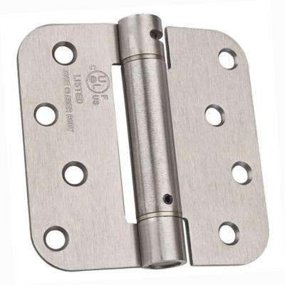

I would suggest a cheap alternative, but it might be too subtle. I'd look at adjustable spring hinges. If there were three on a well hung door, they will probably close it, or at least pull it very close to latched. I usually put one on doors that aren't level and want to stay open if I can't level the door any other way.

Or just fit self closing hinges. Lots of versions exist. Not all lift the door like these...
I'll also suggest you go for a simple & quick solution like self-closing hinges shown above.

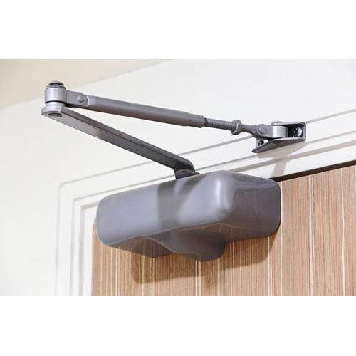

These.
Simple lift or spring closures are OK, but the devices pictured above allow the door to close slowly, in a damped fashion, until the last few degrees where they release the damping. This slams the door slightly so the latch can engage. Otherwise your door will end up ajar, resting on the latch.
A motorised door would have to be quite torquey to swing the door from that position, would have to shut off in an overcurrent situation (someone standing in the door way, holding it open) and would be quite hard to mount elegantly.
