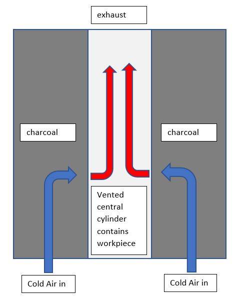

I'm looking to build a charcoal forge for my garden - and I have a thought for a redesign.
I'm going to be taking up some ironwork as a hobby again, which I dabbled in a few years back. I had a forge made of a brake hub, and it worked quite well. I'm now considering a redesigned charcoal forge and I thought I would run an idea by you guys, who are probably more knowledgeable than me on the nature of fire!
The idea is to have 2 cylinders, one inside the other. the inside of the large one is filled with burning charcoal, and the inner one is where the workpiece is placed. the inner one is perforated full of holes, to let the hot gases pass through.
My theory is that the hot gases from the charcoal can be pumped into the inner cylinder, heating the workpiece as the air feed makes the charcoal burn hotter. This theory relies entirely on the idea that the gases released by the charcoal will make it hot enough to make steel glow, without actual contact with the charcoal.
The outer cylinder would be capped and would need a constant feed of air to keep it burning. The inner one is perforated and open at the top. The outer cylinder would have an air-feed from a fan of sorts to pump the air through.
I suspect that the air wouldn't heat up enough to make this effective. My goal is to make something akin to a gas forge, but without the need for a gas bottle and the potential explosion that goes with it! I'm confident in my abilities to make a pot of fire, but not in working with gas!
Most forges I've seen have the workpiece sitting directly in the coals. Does that happen in your design? It does not look like that to me.

How does one handle the workpiece with the hot gases rising to meet your hand when you want to fish it out? Jim has a good point for handlng the workpiece easily and quickly and sturdily with the grippers.
What material would you consider for the inner cylinder?
After how many uses would it take for it to corrode?
@some bloke I assume your brake drum forge had the work-piece directly on the fire. Why would you want anything different since you'll never get as much heat indirectly ?
If your gases are hot enough to soften the workpiece, won’t they melt your inner cylinder?
Both cylinders will sink heat away from the gases, and the more air you pump in, the more they will be cooled. I can see you chasing your tail on this one (and flaying the skin off your arm when you extract the workpiece).
Much simpler would be a deep V channel with a perforated tube at the bottom. Fill with coal, light it, and pump air into the tube. If you watch a blacksmith at work, he will generally bury the piece in the coal, suggesting hot gases are not enough - you need direct contact with brightly burning coal.
To be fair to the OP, the design does account for some loss due to radiation of the workpiece, but put a crucible in the inner tube and some kind of vented lid to reflect vertical radiation and presto, you have a kiln.

Thankyou all for your replies!
I guess I just liked the look of the gas forges I've seen, but didn't fancy trying to make one because gas is dangerous!
I will be making a traditional type forge, where the metal goes in the coals!
