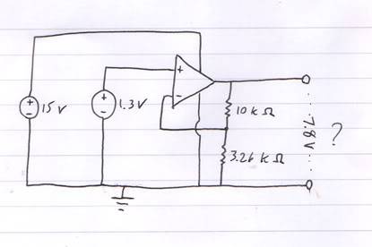

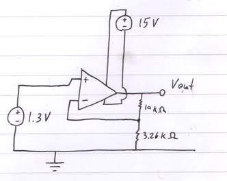

I am play with and op amp right now but getting unexpected results. I am trying to create a non-inverting amp. Here is how I have it hooked up:
According to my calculations, I should be getting about 5.3 volts between the output and ground, but my voltage meter is showing 0.22 volts. Any ideas what I am doing wrong?
Ground the negative side of the 15 volts.
Bob S
I tried that, but now I get a constant 7.8 volts no matter what the input.
Use your original circuit and hook up the 15V power supply to 2 series connected 1k resistors forming a voltage divider. Use this divider to bias the signal ground at 1/2 of the supply voltage. This "virtual ground" should be used as a reference for all other measurements. For example your power supply measurement at pin 7 (V+) should measure +7.5V and pin 4 (V-)should read -7.5V. Be sure to connect the negative terminal of your 1.3V input signal to this virtual ground. This is a crude method of providing a balanced supply for your circuit but it should work for your purpose. In the future you may want to use a split power supply that provides both positive and negative voltages.

JerryG said:
Here is the new configuration:
Why do I just get the same 7.8 volts no matter what the input voltage? Here is the amp I am using:
http://www.datasheetcatalog.org/datasheet/nte/NTE975SM.pdf"
You might choose a better op amp that allows input signals that included ground.
In the data sheet you will likely see VSS+0.0V or VSS-0.1V for values named something like VIN+ and VIN-.

OK, I tried this method and I am getting +7.5 v at V+ and -7.5 at V-, but now I am just getting a constant 6.5v from the output. The input voltage does not affect the output voltage.

I have checked the connections many times. Voltage meter works properly. I even tried something simple like a voltage follower (buffer amplifier) and it did not work. I guess I could go buy another op amp. What are the chances that a brand new op amp from frys came DOA?
It is possible that your circuit layout is such that there is excessive inductive coupling from output to input at high frequencies, leading to an oscillation. I suggest you use your corrected ckt diagram in post #4, with a single 1nF to 10nF capacitor in parallel with the 10k feedback resistor to add a little stability. What is your circuit layout, and is the IC in a socket? You have the same pinout as an 8-pin 741 available at Radio Shack and elsewhere, so that is a reasonable substitution.
