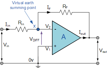

Can you post some links to the reading you have been doing about opamp circuits? It will be easier to help you if you post some of your reading, and ask specific questions about that reading. Thanks.
Typical inverting opamp circuits like this, right?
https://www.electronics-tutorials.ws/opamp/opamp6.gif
Circuit schematic of an inverting op-amp amplifier with a virtual earth summing point labelled x, input resistor Rin, feedback resistor RF, and labelled currents and voltages Iin, IF, Iout, V2, V1, VDIFF and Vout, with the non-inverting input at 0v.
  • Circuit schematic of an inverting op-amp amplifier with a virtual earth summing point labelled x, input resistor Rin, feedback resistor RF, and labelled currents and voltages Iin, IF, Iout, V2, V1, VDIFF and Vout, with the non-inverting input at 0v.
We almost always use inverting op amps, so I'll answer that.
The net input to the OP amp is the difference between the incoming signal and the feedback signal (both signals connected via a resistor). The secret is that high amplification forces that difference to be almost zero.
Think of the OP amp gain as a big but finite number G. Then if the output signal is 1 volt, then the net input to the OP amp must be 1/G, which is nearly zero if G is large.

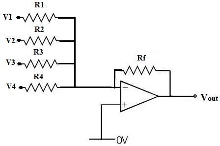

In the diagram below, the net input to the op amp is defined by the connection points marked + and -.

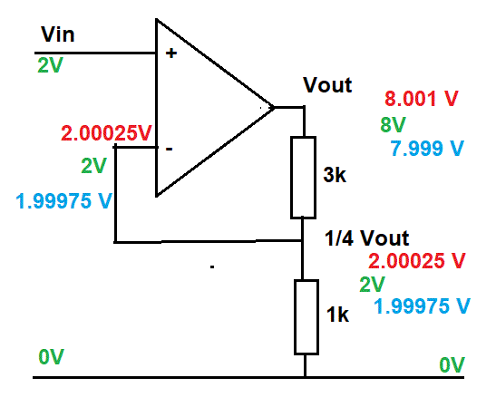

I won't avoid numbers, but perhaps i can keep the maths simple.
First a reminder of how the op=amp uses its two inputs.
If the + input has a higher voltage than the - input, then the output voltage goes up towards +
If the - input has a higher voltage than the + input, then the output goes down.towards - (or zero if there's no -ve voltage rail.)
Here's a non-inverting circuit using an op-amp. It gives a gain of 4 (closed loop gain.)
The output has two resistors between it and 0V, so that the output voltage is split, 1/4 across the 1k resistor and 3/4 across the 3k resistor.
The green writing shows the 2V input and the expected x4 = 8V output.
It shows the 1/4 of output = 2V above the 1k resistor (the other 6V are across the 3k resistor.)
And this 2V is fed back to the inverting input, making it the same as the other input.
Non-inverting op-amp circuit with Vin = 2V on the + input, feedback from Vout divided by 3k and 1k resistors to the - input, giving 1/4 Vout = 2V, with annotated voltages 2.00025V, 1.99975V, 8.001V, 7.999V.
In red I show the output voltage drifting a little above 4x the input. If you follow the red numbers, you see that 1/4 of this voltage gets back to the inverting input. So now the inverting input (-) is higher than the non-inverting input (+) and it will make the output go lower, which will bring it back down towards 8V.
In blue I show the output drifting a little below 4x the input. Following the blue numbers, 1/4 of the output gets back to the inverting input. Now the + input is higher than the - input, so the output will go up, back towards 8V
When the 2V is first applied to the input, no matter what the output is it will be driven up or down as needed towards 8V. There it will be stable as long as there is no differece (actually a very tiny difference, maybe about 0.00001 V) between the two inputs.For this sort of amplifier, the actual "closed loop" gain is set by this pair of resistors. Here we feedback 1/4 of the output and gain is 4. If we feedback 1/10 of the output, gain is 10. Feedback 1/20 th of the output, gain is 20.
The less we feed back to the negative (inverting) input, the greater the gain (the fractions were getting smaller, so the gain increased.)
If we feed back all of the output, the gain is 1, so no gain at all - the output is the same as the input. Sounds silly, but it's very useful. We give the input a voltage, but we don't have to give it any current (well just a tiny bit, like 0.0000001 A or less ) and the output gives exactly the same voltage, but able to supply maybe as much 0.1 A, certainly enough to light a LED, flip a relay or drive a nice big transistor to give even more power.
