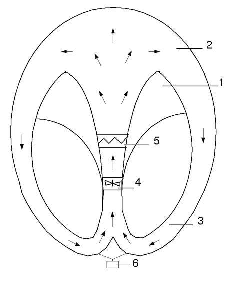

global_frozin
Please, write what is wrong with this reasoning:
ATMOSPHERIC POWERPLANT
The main idea of global warming is that greenhouse gases prevent the energy from leaving the surface of planet. In the same time the upper layers of the troposphere are much colder and successfully emit the infrared radiation to the outer space. So to stop the global warming it is necessary to organize the moving of the heat from the lower layers of the atmosphere to the upper layers.
Also we know that the heat engine performs the conversion of heat energy to mechanical work by exploiting the temperature gradient between a hot "source" and a cold "sink". So the moving of the heat from the lower layers of the atmosphere to the upper layers can be done with some output of the mechanical work. The amounts of this mechanical work can be huge as we know on example of a tropical cyclone. The working body of the cyclone is simply the moist air, which releases the heat by water vapour condensation when rises. So to make the atmospheric heat engine it is necessary to make the construction in which the moist air is circulating in organized manner between the lower and upper layers of the troposphere. Therefore the height of this construction has to be about the height of the troposphere. Also this construction has to be able to withstand the strength of the winds. These requirements can make the creation of such constructions too expensive and non profitable.
To solve the construction problems of the atmospheric heat engine the present synopsis suggest to use the principles of the hot air balloon. If the moist air, which is the working body, will have the average temperature, which is higher then the average surround air temperature, then the atmospheric heat engine will be buoyant. In this case the powerplant will travel with air and it will not be necessary to withstand the winds. Also in this case the construction will be as light and cheap as possible for such a device.
To get the additional energy to keep the average temperature difference the atmospheric powerplant can convert some part of produced mechanical work back into the heat energy. Also to minimize the necessary temperature difference the device can be constructed as Rozière balloon which has separate chambers for a non-heated lifting gas (such as hydrogen or helium). While traveling over the water surface the atmospheric powerplant can replenish its hydrogen reserve by converting the water into the hydrogen and the oxygen. In this case some part of hydrogen can later be used as fuel to increase the temperature of the working body.
The possible structure of the atmospheric powerplant is depicted as dissection on the picture:
1 - chambers for a non-heated lifting gas
2 - top part of the balloon, which dispose the heat to the top layers of troposphere
3 - the lower part of the balloon, which absorb the heat from the lower layers of troposphere
4 - turbine, which convert part of mechanical work into electricity
5 - heating device, which works using electricity or hydrogen combustion
6 - utility unit which works as ballast and can contain electrical accumulators, control system, pilot cabin, wires and pipes to connect with the ground, connection sockets, etc.

Adding a vertical turbine won't create flow, it will restrict flow, harnessing energy that is already there. In this case, it would just be harnessing thermals. But no need: As your diagram correctly indicates, the flow is circular, so you can harness it at any point in the cycle, such as horizontally on the ground. Ie, with wind turbines.
Wind turbines depend on weather, sometimes calm, sometimes cyclone. Atmospheric powerplant will try to permanently maintain the cyclone inside .
So it will try to make the windy weather all the time. :-)
The wind turbines do not solve the global warming problem, because they do not change the current atmospheric activity, which is not high enough now to carry the surplus heat outwards the atmosphere.

In order to make wind, you need a fan. So this device will not generate energy, it will consume it.
Also, you misunderstand the issue of the thermal gradient. Thermals start as a bubble of warm air near the ground that rises because it is less dense than the cooler air just above it. But as the air rises, it expands and when a volume of gas expands without a change in energy, it cools. So there is a limit to the height that this air can rise due to the amount of energy in it.
Remember: it is density differences, not temperature differences that create thermals. As I said above, thermals and wind are two parts of the same cycle and this cycle is powered by heat from the sun. It doesn't work at night or when it is cloudy because there is less/no solar heating.

Wind is wind. They all work basically the same way. Cyclones just get their energy from warm water instead of ground warmed by the sun.

Your description is ok, but it doesn't address the claim you made initially: you claimed that your device would increse circulation while generating power. Ie:
The atmospheric powerplant will keep the circled pipe with the moist air in which the flow will go organized, in one direction.
This circle will connect the cold and warm layers of troposphere.
That's all true too, but it does not imply that it will increase the circulation, only that it will harness already existing circulation.
The first law of thermodynamics applies: you cannot increase energy transfer while simultaneously removing eneryg from the system via an interruption of that energy transfer.

No, you won't. You are wrong on both counts.
1. Your device won't increase circulation.
2. You can't increase circulation while generating power.
You didn't say how you think this is similar to geothermal power, but in any case, it isn't.

None of that has any meaning that I can discern. It is jut word salad. Gibberish.

You are fixed on isolated systems. In isolated system it is impossible to generate power by increasing the circulation. The geothermal power is not isolated system. The heat goes one way. Atmospheric powerplant is the same. The heat goes up and then leaves the planet by infrared.
In isolated system if you generate the power you decrease the circulation because the both things are energy which cannot be changed in isolated system.
You consider the atmosphere as isolated system and the wind power as a way to produce electricity by decreasing the circulation. Really, the wind turbines, which are using the trifling amount of atmosphere circulation will slightly intensify the global warming by decreasing the circulation and so decreasing the loss of heat by infrared.
But the atmosphere circulation itself is not isolated system. Every storm or cyclone moves the heat up and so it gets over the greenhouse gases and then leaves the planet by infrared. This is the process which we need to intensify to fight the global warming.
