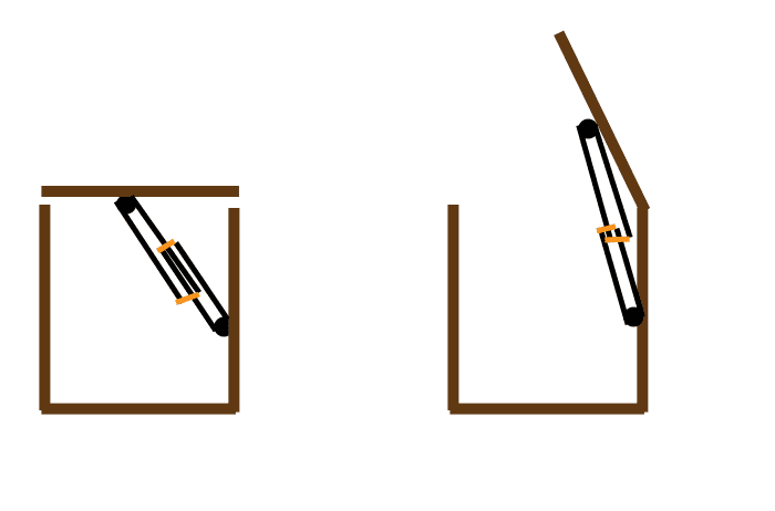

hopefully this post makes sense:/ I am in the process of creating a product that is a gag gift. The gag gift will be electrical and will be activated once the box that it is in is opened. I am wondering if anybody has any ideas on how I can get the product to recognize when the box is being being opened so that It can activate? For example could I have a magnet on the top of the box and on the side a box and when the magnets separate it will send a small radio frequency to the product? Any ideas anybody has would be greatly appreciated thank you in advance!
I built one of these for a game called Assassin. When a hollowed out book was opened, a bank of disposable camera flashes went off in the victim's face, simulating being blowed up.
It is a simple matter of attaching a loop of wire to the box lid - hooked to another loop inside the box. Most of both loops are left insulated - only the last inch is exposed. When the box is opened, the bare wires are brought into contact, closing the circuit.
(The reason you use loops is so that there's no chance they can become detached from each other.)
