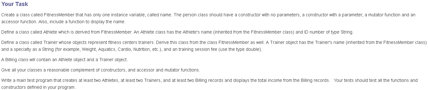

Working on a project here - I've got the classes [MINUS Billing] defined and, as far as I know, meet the requirements for the constructors, accessors, and mutator functions.
My problem lies with the Billing class. It asks me to create an athlete and trainer object inside the billing class but either it was a topic that was supposed to be so easy that it was assumed I'd know it immediately or it wasn't covered. I've spent the last hour or two looking around google and through my textbook but so far I've come up with very little. On top of that, I'm not sure I understand the need for Billing to be its own class to begin with.
View attachment 5573My code:

Hi WarGhSt!
So let's create a Billing class and a couple of Billing records shall we?
It is supposed to track the generated income of a meeting of a Trainer with an Athlete.
Suppose Sally has a training session with Jerry doing Squats.
Then Jerry has to pay the fee of 75.44, which is the billing amount.
So the Billing class should have an Athlete and a Trainer as input and keep track of them.
That means we need accessors and mutators for those.
Additionally we should have an accessor to retrieve the generated income.
Think I've done it! Could you take a look?

Well... that satisfies the immediate requirements... but in object oriented programming we want to keep the logic that belongs to an object inside that object. (Thinking)
We don't want to have to tell a Billing object how much a Trainer charges.
Instead we want the Billing object itself to ask the Trainer how much (s)he charges, which it needs to figure out what the generated income is.
Furthermore, the bills should be for trainers and athletes that are already defined.
The usage in main() might for instance be:
Code:
    Billing aBill(aAthlete, aTrainer);
    Billing bBill(bAthlete, aTrainer);
    cout << "Athlete " << aBill.getAthlete().getName() << ", used trainer " << aBill.getTrainer().getName() <<
        ", and now has a bill of: $" << aBill.getBill() << endl;
    cout << "Athlete " << bBill.getAthlete().getName() << ", used trainer " << bBill.getTrainer().getName() <<
        ", and now has a bill of: $" << bBill.getBill() << endl;
Can you come up with a class definition that allows this usage? (Wondering)
Btw, later on we might want to improve the Billing class such that we can write [m]cout << aBill << endl;[/m].
That is, we want the Billing class to stream to cout (or any other file stream) whatever it thinks should be there, rather than us trying to do that repeatedly. But that's probably for a later exercise.
Oh, and the problem statement also asks for the total income generated from at least 2 billing records...
I'm afraid I'm not seeing what I can do here.
I've tried creating objects inside the class but I'm doing it wrong, I suppose.
It's probably very simple. I just am not getting it.
You don't want to create objects in the class you want the class to take objects as parameters, specifically one trainer and one athlete objects.
Exactly!
We're looking for a constructor like:
Billing( Athlete athlete, Trainer trainer).
Or from a C++ perspective, better would be:
Billing(const Athlete& athlete, const Trainer& trainer).
