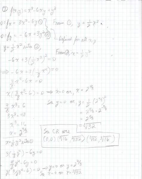

Find and classify all critical points of,
f(x,y)= x^{3} - 6xy + y^{3}
See figure attached for my attempt at the solving all the critical points. I'm getting some weird numbers so I want to make sure I did this part correct before I start classifying them.
Does anyone see any problems?
Thanks again!

hi jegues! :smile:
in line 6, your 1/8 should be 1/4 :redface:
(btw, it would be a lot easier if you divided everything by 3 first)
You can quickly check your work using wolfram alpha... and according to it, (0,0) is one but your other answers are wrong.
