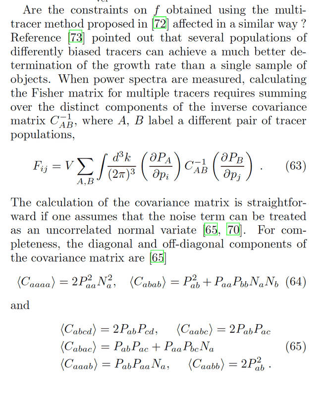

Hello,
I am working on Fisher's formalism in order to get constraints on cosmological parameters.
I am trying to do cross-correlation between 2 types of galaxy populations (LRG/ELG) into a total set of 3 types of population (BGS,LRG,ELG).
From the following article https://arxiv.org/pdf/0909.4544.pdf page 14, there is the following equation (63) :
As you can see, into eq(63), there is a sum on every pair of population types. In my case, I have 3 populations (BGS/LRG/ELG), so the term ##C^{-1}_{AB}## should have a size of 4x4 (with ##aa=BGS\quad##, ##bb=LRG\quad##, ##cc=ELG\quad## and ##bc=LRGxELG##) like this :
##BGS\quad\quad\quad\quad 0\quad\quad\quad\quad 0\quad\quad\quad\quad 0##
##0\quad LRG\quad LRG/ELG\quad LRG/LRGxELG##
##0\quad LRG/ELG\quad ELG\quad ELG/LRGxELG##
##0\quad LRG/LRGxELG\quad ELG/LRGxELG\quad LRGxELG##
But If I take eq(64), eq(65) and compare it with formula eq(63), I can't find the expression of the fourth element for power spectrum factor P_A, i.e when index A=4.
Indeed, If I follow what it is said in Paper, "where A,B label different pair of tracer populations"
I could identify ##P_{A}## to power spectrum for population ##A## and same for ##P_{B}## for population ##B##.
Finally, from your point of view, what's the size of ##C^{-1}_{AB}##, i.e 3x3 or 4x4 ?
and if this size is 4x4, how to sum on the A=B=4 with a power spectrum ##P_{A}## and ##P_{B}## ##(P_{\text{population}=4})## which is unknown since I have only 3 populations ?
On another hand, I think the non-diagonal terms on a covariance matrix 4x4 will transfer informations when I invert this one, and so I can only sum ##C^{-1}_{AB}## on 3 populations for the pair (A,B). I mean their contribution will remain after inversion.
I hope you will understand my issue on this sum. Regards

This doesn't make sense. You've constructed a 4x4 which has diagonal elements aa, bb, cc, bc. That last one cannot fit there.
Ultimately, they're not describing a matrix. They're describing a fourth-order structure. In your case it would be 3x3x3x3. Hopefully that helps get you started, at least.

I am not so sure as you concerning the 4x4 covariance of the observables ##C_{AB}##. Indeed, if I follow the paper, the lines and columns of this matrix are :
"aa bb cc ab ac bc" , such that initially, I have a 6x6 matrix. Given in my case, I have only a cross-correlation between "b" and "c" population, so I get a 4x4 matrix. ( aa bb cc bc).
Caution : the product inside integral of eq(63) is not a matricial product.
My main question is to know if I can do a summation only on (A,B) with A=(1,3) and B=(1,3) and not (A=(1,4), and B=(1,4)) ?
Thanks
No, that's not right at all. It's fundamentally a fourth-order structure. They're packing that fourth-order structure into a matrix.
So instead of a 3x3x3x3, they produce a 9x9., with the diagonal elements coming from eqn 64, and the off-diagonal ones from eqn 65. They can then reduce the size of this 9x9 matrix by noting the symmetries of the system: any swap of any two populations results in the same values. This makes three of the rows/columns identical, reducing it to a 6x6. If you're going to assume that one component doesn't have any cross-correlation at all with the others then yes, you can also remove those rows/columns.
The trick is in making sure that you're respecting eqns. 64 and 65, as they aren't very simple.
Finally, as to how to use this structure, if ##P_a## is the power spectrum of population ##a##, then you have to construct a 4-vector containing the power spectrum of each of the three populations, and a fourth element with the cross-spectrum between the two populations you're assuming are correlated.
If I have 3 populations (marked "a", "b" and "c"), I understand that I have ##3^{4}=81## combinations, since I have 4 digits.
QUESTION 1) But how to interpret the term : ##<C_{abab}>##, I mean why it is qualified of "diagonal term" ? the 3 diagonals terms should be ##<C_{aaaa}>##, ##<C_{bbbb}>## and ##<C_{cccc}>##, shouldn't they ?
Maybe the 3 others diagonal terms are ##<C_{abab}>##, ##<C_{acac}>##, ##<C_{bcbc}>## ? (which would make a total of 6 diagonal terms).
QUESTION 2) Similar problem for the term off-diagonal : what corresponds for example to the term ##<C_{abcd}>## since population "d" doesn't exist ?
How can I do basically the link with the definition of covariance term : ##C_{ij} = E[X_{i}\,X_{j}]-E[X_{i}]\,E[X_{j}]## ?
QUESTION 3) In my case, I have cross-correlation between populations "b" and "c" : from your suggestion, have I got to stay into a 6x6 matrix (with aa, bb, cc, ab, ac, bc) or can I remove the lines/columns "ab", "ac" such way I work finally on 4x4 matrix (aa, bb, cc, bc) ? Sorry I didn't well grasp your reasoning and idea about this point.
