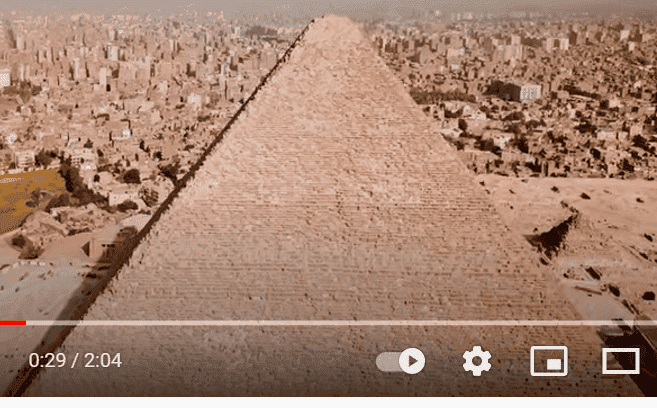

Following is a frame carefully chosen from this drone footage. At about 0:29 into the video the drone is directly in front of one of the four faces (if you know Cairo, you will know which one) and moving from left to right. At that point I have paused and 'frame-stepped' till the moment before the drone swings around the right edge of the pyramid. So my question is , does the picture present an accurate cross-sectional view / silhouette of the Great Pyramid ? One obvious concern is that the faint lines one can see (presumably representing one or other particular layer of stonework) on the pyramid face are not quite horizontal.

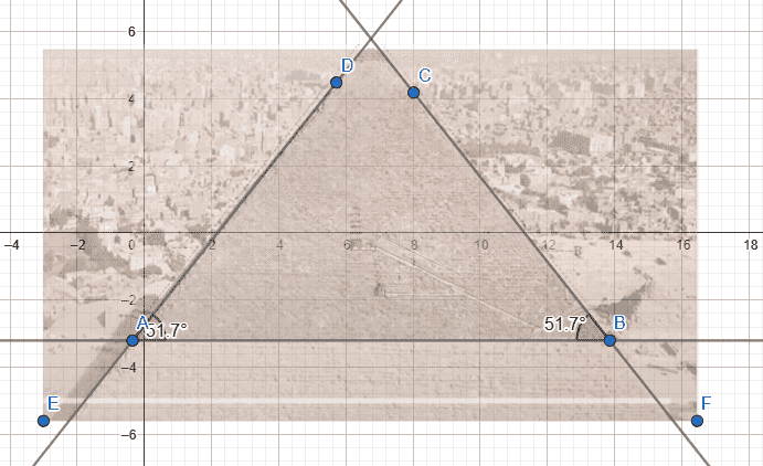

My plan is to super-impose lines along the pyramid edges and then measure the apex angle as well as the slope angle. And hopefully confirm that the base line along with pyramid edges do indeed accurately constitute an isosceles triangle. Further that if a perpendicular is dropped from the apex, the iso triangle will be divided into two equal Kepler (golden ratio) triangles.

Draw a side view showing the height of the drone wrt the pyramid. Is it looking down ?
You will need to know the exact position of the drone relative to the face. An equilateral triangle will image equilateral only from directly normal to the centroid
What I was thinking is that if the drone is placed such that it has a 'side view' of the pyramid then the profile in the pic would be a fair reflection of the cross-section - something like the below. I do not expect it to reflect the exact triangular shape of the face itself. For that the drone would have to point it's camera such that its line of sight is exactly normal to the plane of the slanting face.
The specific frame which I chose is at a single instant in the video when only the 1 face is visible to meet the 'side-on' criterion. I am assuming the camera is pointing (more or less) horizontally but that could be completely wrong.

What is it you are trying to do? I'm not clear on the POINT of this thread. Is it to determine if the pyramid is symmetrical ? If that it, I would think that has been determined many times over by various students of the pyramid.
The issue here is perspective. The nice thing about perspective (without aberration) is that straight lines always map onto straight lines. So if you could somehow locate the two lower back corners you would have a better fit to the center cross-section. Obviously also if the drone is very far away (∞) at base level the elevation you seek and the face will superpose.

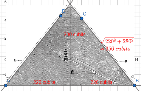

Here is what I'm trying to do. Firstly obtain a 'real-time' measure of relevant angles. Secondly check the Kepler triangle theory. I've constructed the Kepler triangle based on GD being of unit length. It fits like a glove but the caveat is whether I have an authentic cross-section or not. The angles look good in respect of same. I wonder if a much more accurate determination could be made along similar lines.
Construction:
1. M is midpoint of CD which we are taking as the base of the triangle.
2. From M we draw a perpendicular to point I (just off diagram at the top) such that MI = GD
3. Construct J as midpoint of MI and arc MJ down to the horizontal at K.. Join KI which by Pythagoras thm is of length ##\sqrt{5}GD/2##.
4. With K as centre and radius set to KI arc down to base at D showing that ##MD=\phi GD##
Yes indeed. I'm not worried about getting the whole triangle right down to base since the shape is the same all the way up. What I need to make sure of is that the drone picture accurately reflects the centre cross-section so we can check if it lines up with following:
I should indicate that whereas above shows sides ##\Phi,\sqrt{\Phi}## and 1, I have effectively constructed ##1,\sqrt{\phi}, \phi## which is a similar triangle. ##\Phi=\frac{1+\sqrt{5}}{2}## and ##\phi=\frac{\sqrt{5}-1}{2}##

With one image you will still need to know the relative position of the camera. For instance, if you know the camera is in the base plane of the pyramid, then you must know its distance from the two nearest corners. Or if it is face centered exactly you need to know its distance from the face.
One method to obtain this data is to include a known target in the image, and infer the absolute camera position from image of the target.
Another useful method is to use stereo views of the pyramid and locate the corners on two images . Better be good at projective geometry. Also you need to know the exact relative orientation of the two camera images.
If you really are trying to obtain precise measurements, a single image by itself will not suffice.

Normal to the altitude. In simple terms imagine if somehow one could shine a huge torch on the pyramid and then capture the shadow on an imagined huge screen placed behind. In essence that's what I thought the drone pic would be and the measured slope angle I obtain is 52 degrees. Not very far out from the 51.8 or so which is the commonly accepted value.
Here I try the same idea on a small paper model of the pyramid I have made. Again it is a very crude pic - I can' t get the horizontal alignment right. Also I don't have any method of holding my cellphone vertical. All the same the measured angles are clearly enough cross-section angles - that is angles of the pyramid's sihouette and not of the face itself. So I think that's good enough as "proof of concept". The technical challenge is to implement it with perfect camera alignment. Then you should get a 'perfect silhouette'. Or am I misunderstanding the physics of projection / projective geometry ?
You are misunderstanding. The method you propose will only be exact if you are infinitely far away. The angle subtended depends upon both the actual spatial separation and the distance to the lens.
