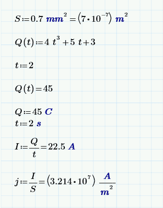

Wire, with diameter of 0.7 mm2, is used to charge a capacitor. Charge on the capacitor plate is described as: Q(t):=4*t^3+5*t+3 [C]. What is current density in a wire, at given time t=2s?
Q(t):=4*t^3+5*t+3 , j=I/A , I=Q/t
Handwritten working on squared paper: S = 0.7 mm^2 = (7 x 10^-7) m^2; Q(t) = 4t^3 + 5t + 3; t = 2; Q(t) = 45; Q = 45 C, t = 2 s; I = Q/t = 22.5 A; j = I/S = (3.214 x 10^7) A/m^2.
Somehow this answer is incorrect , but i realize that even numbers are hipothetical , 45 coulumbs is too much charge , what is wrong in my calculations?
Q(t) is the total charge on the capacitor, including what has accumulated in the past. The current in the wire is the rate at which new charge is added/removed.
Okay , but I = Q/t so that's 12.5 A in the wire at the moment t=2, but why isn't the answer correct , is there some kind of a mistake in calculation?
As @DaveE pointed out, the current I in the wire at the instant t = 2 s is the instantaneous rate at which charge is flowing through a cross-section of the wire. This must equal the instantaneous rate at which charge is arriving at the plate of the capacitor at t = 2.
How do you calculate the instantaneous rate of change of some function of time?
The equation I=Q/t can’t be used here. This equation applies to situations where current is constant or we only want the average current. T help you understand your mistake, try this problem:
An object moves along a straight line so its distance (x) from a reference point (x=o) is given by:
x(t) = 4t³ + 5t + 3
Q1. What is the object’s average speed during the interval t=0 to t=2s?
Q2. What is the object’s speed at the instant t=2s?

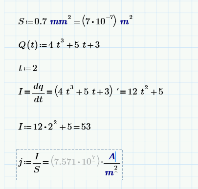

Thanks guys , I managed to solve it using derivatives , your help much appreciated.
Worked calculation on graph paper: S = 0.7 mm^2 = (7 x 10^-7) m^2; Q(t) = 4t^3 + 5t + 3; t = 2; I = dq/dt = (4t^3 + 5t + 3)' = 12t^2 + 5; I = 12 x 2^2 + 5 = 53; j = I/S = (7.571 x 10^7) A/m^2.
Well done. But don't forget that 0.7mm² and 2s are each specified to only 1 significant figure.
