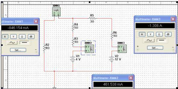

what is the current in each of the branches in this circuit:
[PLAIN]http://img593.imageshack.us/img593/893/resisotrcurrentquestion.th.jpg
http://img593.imageshack.us/i/resisotrcurrentquestion.jpg/
v=ir
r1+r2 = r3
1/r1 + 1/r2 = 1/r3
v1 + v2 = v3 ?
im guessing this has something to do with simultaneous equations but I am not sure about the extra battery. And which circuits am i supposed to pick, because i can see 4 different paths (2 for each battery) and am not sure if i need to have the battery's in different paths or not.
basically I'm very confused any help would be appreciated
thank you

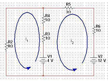

Okay, that would be a KVL method (Kirchhoff Voltage Loop).
Your circuit comprises two obvious loops. Sketch in a separate current loop for each, then do the "walk" for each. Be sure to take into account that components shared by two loops will have both currents going through them, so both currents will appear in the terms for the voltage drops (or rises) for such components. This will result in two equations in two unknowns (the two independent loop currents).
Here's your circuit with two current loops sketched in:

so the equations for the two loops you indicated would be
+ 12V – 4V – (I*3) – I*5 – I*1 = 0
+4V – I*1 – I*5 – I*8 = 0
i've done something wrong as these equations do not work
ok now I am even more confused by what you said sid,
I built this circuit on multisim, and got the attached results
First, use two separate currents. I've indicated i1 and i2 on the diagram.
In your first equation (which appears to be for loop 2), you should have an entry for every component that the loop current passes though. So, walking around the loop,
+12V - i2*R6 - i2*R5 - (i2 - i1)*R4 - (i2 - i1)*R3 - 4V = 0
Once you've done that you can do the algebra to collect the i1 and i2 terms.

ok i think i understand it now
so i2 would be the reading on xmm3
and i1 would be xmm1
and xmm2 is i2 - i1

ok so these are the two equations
+4V – (i2-i1)R3 - (i2-i1)R4 – i1*R2 = 0
which gives me i1 = -0.1429A and i2 = 0.7143A
which is not correct
For your second equation you should have
+4V - (i1 - i2)R3 - (i1 - i2)R4 - i1*R2 = 0.
Note that you always count a voltage drop when the current passes through the component in the direction that you "walk" around the loop. So you must have -i1*R3 and -i1*R4 and since the current in the other loop flows in these components in the opposite direction (causing voltage *rises* rather than drops), +i2*R3 and +i2*R4.
well multisim understands it...

thank you both for your help
i managed to get the correct answers and more importantly gained more understanding on the topic.
