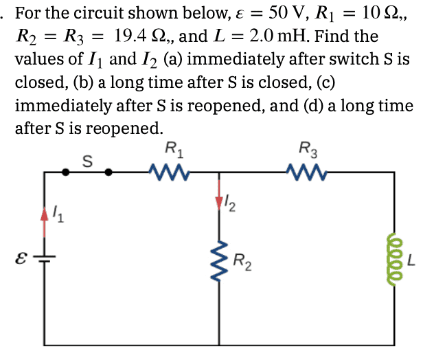

For the circuit shown below, v = 50 V, R1 = 10 ohms, R2 = R3 = 19.4 ohms, and L = 2 mH. Find the values of I1 and I2 (c) immediately after S is reopened
##\frac{LdI_3}{dt} + I_2 R_3 + I_2 R_2 = 0##
##I_2 = \frac{V}{R_3 + R_2}e^{-t/\tau}##
##I_2 = \frac{50}{19.4(2)}e^{-t/\tau}## as t goes to 0, ##I_2 = \frac{50}{19.4(2)}## = 1.29 Amps which is not the answer.

I think you do a similar mistake here as the one at the other thread (where you used ##\frac{\mathcal{E}}{R}## instead of ##\frac{\mathcal{E}}{2R}##)
For (c) that is immediately after S is reopened ##I_1## drops to zero and ##I_2## becomes equal to ##I_3##.
##I_3## can not change instantly because it is the current through the inductor, while we can make the assumption that the current through ##R_1## and ##R_2## can change instantly.
P.S As ##I_3## I refer to the current through the inductor (and ##R_3##) immediately before we commit action (c). That is the current through the inductor at the end of (b).

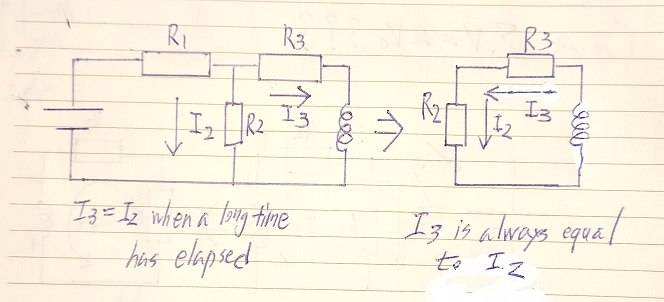

There seems to be a bit problem with this definition. Why define a ##I_3## if it is always equal to ##I_2##?
Why not just use the original ##I_2##, isn't it simpler and more convenient?
If ##I_3## is not always equal to ##I_2##, e.g. ##I_3=I_2## only after the switch ##S## is reopeoned, we cannot define that ##I_3 \cong I_2##, the position and direction of ##I_3## should be accurately marked on the circuit to avoid misunderstanding, although we might be able to infer the direction of ##I_3## from the relationship.
Edit : But you also didn't explicitly say that ##I_3## is equal to ##I_2## only after the switch is reopened.

Here's an alternative approach.
The times of interest are the initial times (‘t=0’) and the steady-state times (‘t = ∞’). As a consequence, the questions are easily answered by understanding and applying three key facts about how an inductor behaves in a DC circuit like the one given:
1. For an ‘uncharged’ inductor, when the applied voltage changes suddenly, the inductor behaves (for an instant) as an infinite resistance (open circuit).
2. When the charging inductor reaches its steady state, it has zero voltage across it and a constant current (call it I₀) through it. The inductor acts as a zero resistance.
3. When the charged (steady-state) inductor discharges, the initial current through it is I₀ (as defined in point 2 above) and the final current through it is 0 (assuming no other sources are present).
If the above facts are applied, the questions can be easily answered without any differential equations. In fact this approach makes it obvious that the answers don’t even depend on the value of L!

I meant ##\frac{LdI_2}{dt} + I_2 R_3 + I_2 R_2 = 0## if that makes it clearer since I2 = I3. When I solve this differential equations, ##I_2 = \frac{V}{R_3 + R_2}e^{-t/\tau}##, but as t goes to 0, I2 = 1.29 amps which is not the answer.

Ok, you mentioned in your first post that you were just focusing on finding an answer to question c ( immediately after S is reopened), which I seem to have missed.
Then we need to know what is the steady-state current of the inductor after the switch is closed for a long time, and this value is obviously not equal to ##\frac{V}{R_3 + R_2}=\frac{50}{19.4(2)}=1.29## :smile:

You used wrong initial condition when solving the ODE. It is NOT $$I_2(0)=\frac{V}{R_3+R_2}$$ rather it is ##I_2(0)=##the current the inductor has at the end of (b) (that is immediately before (c) happens).

Not "always". The two currents are not equal after the switch is closed in part (a). They become equal when a "long time" has elapsed.

The ODE you formed(at post #25) is correct. The general solution to that ODE is $$I(t)=Ce^{-t/\tau}$$ where $$\tau=\frac{L}{R_2+R_3}$$.
Now to determine the constant C you use as initial condition $$I(0)=\frac{V}{R_2+R_3}$$. I am going to throw the little ball to you now (direct translation from Greek idiomatic phrase e hehe). Please elaborate why you think that the initial current of inductor is that i.e ##\frac{V}{R_2+R_3}##, I mean, the voltage source V is detached from the loop when (c) happens, I really don't understand you here.
