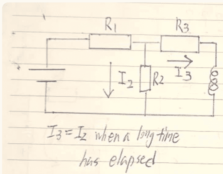

I find it remarkable that after an entire page of posts the OP still refuses to define the direction of his currents. Without properly taking current directions into account and with just handwaving arguments like ”currents have to be the same” without any reference to current direction, we will not progress.
Sorry if I didn't answer your questions clearly. The directions of I2 and I3 are below. I3 = I2 when the switch is open

Orodruin said:
Another fundamental fact that the OP ignores is that current through an inductor changes continuously. This is the same type of issue that was treated in another of OP’s recent threads.
Yes, I know that. That's why in my first post I have ##\frac{LdI_2}{dt} + I_2 R_3 + I_2 R_2 = 0## where that is kirkoff's loop laws for the I2 circuit with the inductor, solving for I2, we have ##I_2 = \frac{V}{R_3 + R_2}e^{-t/\tau}## where I2 is the current going through the inductor
Do you understand the concept of polarity? |I2| = |I3| isn't the same as I2 = I3.
In your diagram if I2 = I3 then (by KCL) the current through R1 must be I2 + I3, which will be hard to achieve if the switch is open.
It looks to me, from your diagram that I2 + I3 = 0 thus I2 = -I3 when the switch is open.
Yes I2 = -I3...wondering if you could help me solve the problem from here...

Maybe try to simplify the problem as shown below. Reopen the switch after the circuit has settled down, is it possible that the initial current of the inductor is ##~\frac{E}{R1+R_2}=\frac{1}{1+1}=0.5A ## ? :cry:
