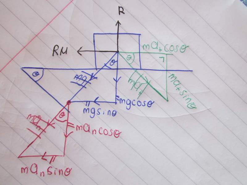

So I don't think I did it correct. I got an answer of 10.873°.
I started off with the forces on the box being mgsinθ parallel down the plain and mgcosθ perpendicular into the plain.
I broke up m x 4 (... mass x acceleration) into two components, 4mcosθ acting parallel to and up the plain, and 4msinθ acting into the plain.
Angle for slip...
mgsinθ + (mgcosθ + masinθ) x μ = macosθ
(g+μa)sinθ = (a - μg)cosθ
θ = ArcTan [(a-μg)/(g+μa)]
θ = 10.87°

Could you attach your FBD? That would be a help in figuring this out...
http://s1372.photobucket.com/user/cmcdona22/library/?sort=3&page=1

Sorry, maybe I confused you with my reply. The motion of the car on the curved surface adds an additional acceleration beyond just gravity. That term should also be added in.
Is that an additional tangential and normal acceleration?
The braking force would be tangential and the centripetal force would be normal, right?
Hey Berkeman, does this look okay to you?
I followed it through and I got an answer of 3.8° which is isn't right, but I think the FBD looks okay.
Thanks,
cmcd
