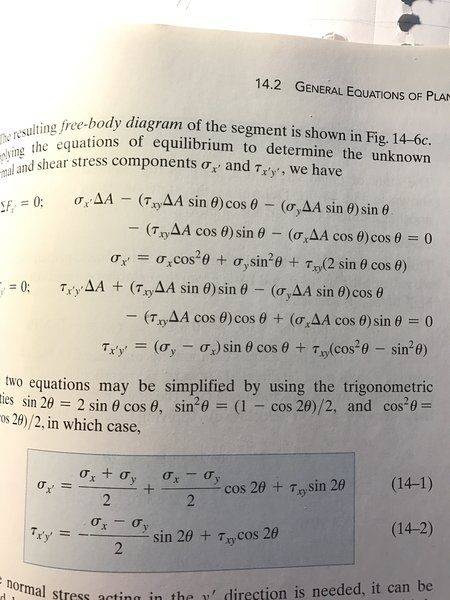

Why are equations written in double angle form?
  • Thread starter EastWindBreaks
    Angle Form
EastWindBreaks
128
Printed textbook page showing stress transformation equations (14-1) and (14-2) boxed, with sigma x' and tau x'y' expressed using cos 2θ and sin 2θ, preceded by equilibrium equations.
I guess this is a general question. in the book, it was originally in a normal form, but it was then converted into a double angle form, which I would have to use double angle formula to compute, so what's the point of simplifying in the first place?
I guess it depends on what your unknown quantities are. The formulae in the gray box are much simpler, so there is less opportunity to make a mistake. That would be one advantage. Also, if it is something that you are memorizing, it is less to memorize, rather than all of those sin(theta)cos(theta) etc, for example.
I guess you are right, its more compact, easier to remember.
