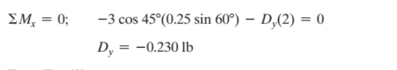

Hi, I am still not getting it. cause the answer key i think says that it would have moment about x::
Handwritten moment equation: sum of Mx = 0; -3 cos 45°(0.25 sin 60°) - Dy(2) = 0, followed by Dy = -0.230 lb.
