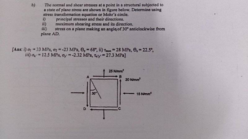

Why can't i use the equation to determine the normal stress and shear stress ? Is my concept wrong ? I use the method in the link to do this question. The question said the
stress on a plane making angle 30 degree anticlockwise from plane AD .
When it's anticlockwise , the angle is positive

Mod note: Image of work has been deleted. OP will be including work in a subsequent post.[/B]
$$\sigma _(max) $$ = ((25-15 )/2 ) + 20cos60 + 20sin60 = 32.3MPa$$\sigma x_(min) $$ = ((25-15 )/2 ) - 20cos60 - 20sin60 = -22.3MPa
But the ans is 12.5 and -2.3MPa
##r = sqrt ( ((\sigma _x -s \sigma_y) /2 )^2)+ (\tau_xy)^2) = 28##
##tan2\theta_p = 2\tau_xy / (\sigma _x -s \sigma_y)
= 2(20) / 40## , ##\theta_p = 22.5## degree ,
This is different from the ##\theta_p ## = -68 degree given
Image for mohr's circle
https://www.physicsforums.com/attachments/dsc_0038-jpg.110448/
Is the ans provided wrong ? Or is my concept wrong ?
