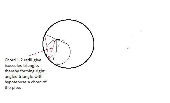

Do you agree that ##\alpha - \theta = \phi/2##?
No, I don't agree with this. My expression contains both ##R## and ##r##. How did you get the 1/2 factor on the right side?

I 'derived' it from a series of geometric observations using the triangles I posted earlier. Here is what I did:
In the isosceles triangle, I have that ##2x + \phi = \pi \Rightarrow x = (\pi-\phi)/2##. Then sum the angles along the radius of the pipe shown in the question (a portion of this radius is a side of the right angled triangle shown in the sketch). This gives ##\pi = \pi /2 + x + λ## which means ##\lambda = \phi/2##.
Summing up the angles in this triangle now (the triangle where the symbol ##\alpha## is printed in the question) gives ##\pi = \lambda + (\alpha - \theta) + p##, where ##p = \pi - \phi##. Subbing in and solving gives ##(\alpha - \theta) = \phi/2##.
Could you follow that? If so, does it make sense?
I'm sorry I can't follow this without a picture showing the specific triangles with which you are working. Any way you could attach one?
I don't see how your chord of the cylinder meets a radius of the pipe to form a right triangle. If you were to draw the cylinder with a considerably smaller radius r, would you still be able to construct your triangles?
You're right, it doesn't. Okay, so the reasoning is that since all angles are measured in the same sense and there is no slipping of surfaces, when a point on the pipe undergoes an angular displacement ##R(\alpha-\theta)##, the same point on the rim of the cylinder undergoes an angular displacement ##r\phi##?
The rest of the question was fine, thanks TSny.
Yes, the constraint is ##r\phi = R(\alpha-\theta)##.
