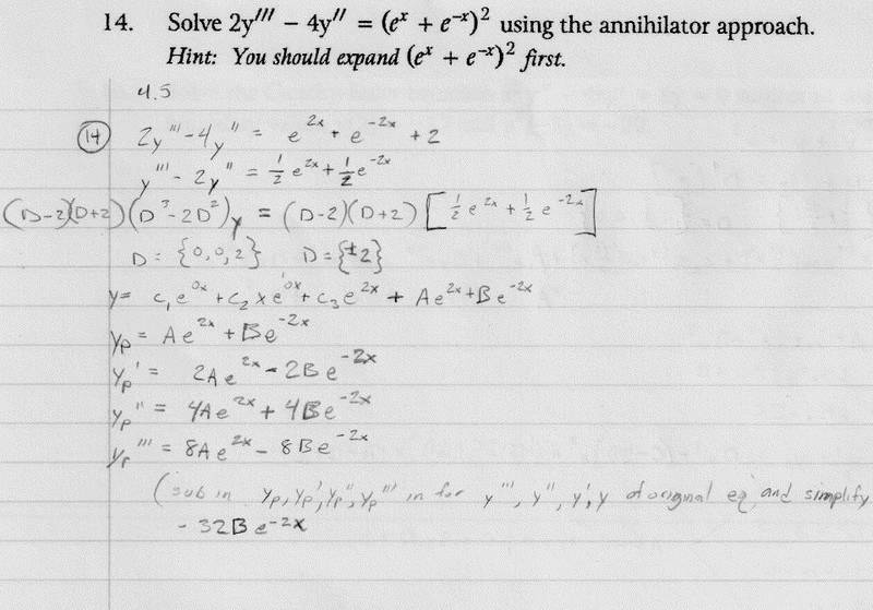

I lost the A variable when I simplified this. Did I go wrong somewhere?

You're still not getting this - you're making the same mistakes you made in a previous post a week or so ago.
The roots of the homogeneous equation 2y''' - 4y'' = 0 are r = 0, r = 0, and r = 2.
This means that the solutions of this equation look like y = c1 + c2t + c3e2x.
Now for the nonhomogeneous equation 2y''' - 4y'' = e2x + 2 + e-2x, we would ordinarily seek a particular solution of the form yp = Ae2x + B + Ce-2x.
BUT, and this is important, and is what you're not understanding, e2x and 1 are already solutions of the homogeneous equation, so could not possibly be particular solutions of the nonhomogeneous equation.
The root r = 0 is already repeated in the homogeneous equation, which led to solutions of the form c1 + c2t. Since there is another repetition of r = 0 in the nonhomogeneous equation, we need a solution for the nonhomogeneous equation of what form?
The root r = 2 is already used in the homogeneous equation, which led to the solution c3e2x. So in the nonhomogeneous equation we need a solution of what form?
Note that e-2x is NOT a solution of the homogeneous equation, so it will appear unchanged in the particular solution of the nonhomogeneous equation.

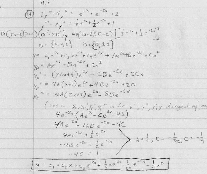

I ended up realizing my mistake I think. Yes, it was the same error I made before. I got:
y = c1+c2x+c3e2x+Axe2x+Be-2x
which resulted in a final answer of:
y = c1+c2x+c3e2x+\frac{1}{8}xe2x-\frac{1}{32}e-2x
Is that right?

No, not quite. The general solution of your nonhomogeneous equation will be composed of six functions, which corresponds to the number of roots (six) of the characteristic equation of the sixth-order homogeneous equation.
To expand on that a bit, your original 3rd order nonhomogeneous DE could be written as 2(D3 - 2D2)y = e2x + 2 + e-2x, or 2D2(D - 3)y = e2x + 2 + e-2x.
The homogeneous equation is 2D2(D - 3)y = 0, and its characteristic equation is 2r2(r - 2) = 0, with roots r = 0, r = 0, and r = 2.
An independent set of solutions is {e0 = 1, xe0 = x, e2x}
Using annihilators, we see that the operator that annihilates the right side of the original DE is (D - 2)(D)(D + 2). This means that the 3rd-order nonhomogeneous equation can be transformed to a 6th-order homogeneous equation.
2(D - 2)(D)(D + 2)D2(D - 2)y = (D - 2)(D)(D + 2)(e2x + 2 + e-2x) = 0.
The general solution of this 6th-order DE will consist of six linearly independent functions, if which three will be the complementary solution of the 3rd-order homogeneous equation, and the other three will come from the right side of the nonhomogeneous equation, and that we'll use for a particular solution.
So, yc = c1 + c2x + c3e2x.
And, yp = A____ + B_____ + Ce-2x
Remember, the root r = 0 was of multiplicity three, and we have accounted for two of them in yc, so what do we need in yp?
Also, the root r = 2 is of multiplicity two, and one of them is in yc, so what do we need in yp?

Hold on, I divided the original DE by two. Is that not valid?
Not unless you also divide the right side by 2. If it were a homogeneous equation, you could do that, but it's a nonhomogeneous equation.
Oh, I should've had a one on the right side. Simple math mistake. 2/2 does not equal 0! I did need to divide the entire thing by two didn't I?

Is this right?
You can check it yourself, you know. You can do it in two parts.
1. Verify that D2(D - 2)[c1 + c2x +c3e2x] = 0.
2. Verify that D2(D - 2)[(1/8)xe2x - (1/4)x2 - (1/32)e-2x] = (1/2)[e2x + 2 + e-2x].

Using annihilators, there are three diff. equations you need to keep track of:
1. The original nonhomogeneous equation. In this case, 2y''' - 4y'' = (e2x + e-2x)2.
In operator form, this is 2D2(D - 2)y = (ex + e-x)2.
2. The homogeneous form of the original equation. In this case, 2y''' - 4y'' = 0. In operator form, it can be reduced to D2(D - 2)y = 0.
3. The higher order homogenous diff. equation. In this case, in its operator form, it is
2D3(D - 2)2(D + 2)y = 0. I don't want to do the extra work of writing this in the form 2y(6) + ... = 0.
The general solution of the equation in #3 is made up of six functions, three of which are the solution to #1 (the complementary function), and three of which are the solution to #2 (the particular solution.
From what you've already done, yc = c1 + c2x + c3e2x. Notice that the operator form of #1 has D2 and D - 2. The characteristic equation for #1 has roots r = 0 (twice) and r = 2. The three functions that were chosen tie closely to the roots of the characteristic equation and the operators: {e0x = 1, xe0x, e2x}.
As a check, it has to be the case that 2D2(D - 2)[c1 + c2x + c3e2x] = 0. This is the first part of the check I said you should do. If you don't get zero here, it means you didn't pick the right functions for the complementary solutions
The particular solution, yp, is made up of the other three functions, with yp = Ax2 + Bxe2x + Ce-2x. Since this is supposed to be a solution of #2, the nonhomogeneous equation, it has to be the case that 2D2(D - 2)[Ax2 + Bxe2x + Ce-2x] = e2x + 2 + e2x. This is the second part of the check. If it doesn't end up as it should, it means you didn't pick the right particular solution.
