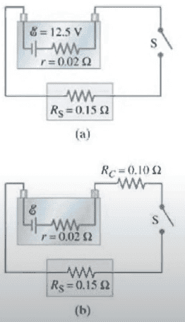

The performance of the starter circuit in an automobile can be significantly degraded by a small amount of corrosion on a battery terminal. Figure 26-38a depicts a properly functioning circuit with a battery (12.5-V emf, 0,02 ohms internal resistance) attached via corrosion-free cables to a starter motor of resistance Rs = 0.15 ohms. Suppose that later, corrosion between a battery terminal and a starter cable introduces an extra series resistance of just Rc = 0.10 ohms into the circuit as suggested in figure. Let P_0 be the power delivered to the starter in the circuit free of corrosion, and let P be the power delivered to the circuit with corrosion. Determine P/P0.

The answer sheet assumes that the resistors in both circuits are in series and that we need to use the equation Req = R1+R2+R3.. to find the Req in both cases. How come the resistors are in series, when there are multiple resistors in a single row?

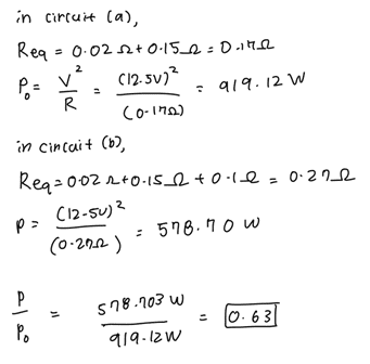

Also, why does the following work yield the wrong answer? The answer should be 0.4, but I keep getting 0.63..
Because the current flowing through all of them is the same.
You need to calculate the power delivered to "the starter". Is it the same as what you have calculated?

There is a mistake in the question.
Sunwoo Bae said:
... and let P be the power delivered to the circuit with corrosion.
It should say:
"... and let P be the power delivered to the starter in the circuit with corrosion."
