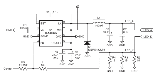

BTW, one way to use a DC-DC buck converter as a constant current source is to have a low-side sensing resistor (small value) to give the converter a small voltage that represents the current flowing through the load. The DC-DC converter uses PWM to maintain that constant average current value.
Like this Maxim circuit for driving LEDs with a constant current:
https://www.maximintegrated.com/en/images/appnotes/3668/3668Fig01.gif
