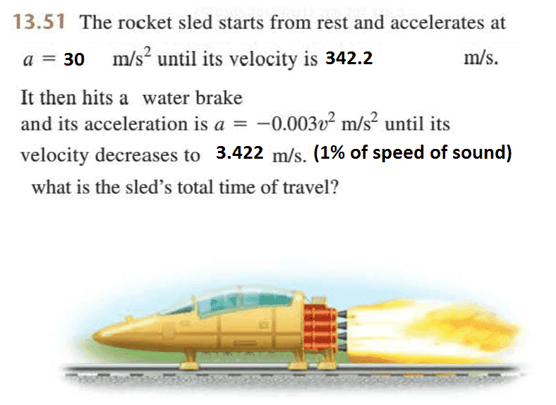

I forgot if the deceleration is -0.003v or same here -0.003v2
v = u + at (first acceleration)
dv/dt = a (deceleratioin) = -0.003v^2
From first equation,
342.2 = 0 + 30*t1
t1= 11.407s
From 2nd equation,
dv/v2 = -0.003
[-1/3.422] - [-1/342.2] = -0.003 (t2-t1)
If the decelerate is -0.003v
dv/v = -0.003
ln (3.422) - ln (342.2) = -0.003 (t2-t1)
t2 (total time) = 1544.46 s
Is the answer making sense?
Updates: should be -0.003 v

Correct, so what is t2, the total time?

In the problem text, the deceleration is a = -0.003 v2, and you did not calculate the time. In case of a= -0.003v, your answer is correct. Use four significant digits.

thanks for reply. The question was using a = -0.003v as deceleration.
And my t is 1544.46s, which is 25 min, is it making sense? because it is soooo long.

Yes, it is correct, with that low deceleration, which is linear in velocity. At that high speed, quadratic deceleration would be more realistic

Okay thanks, I double checked the question, it uses v instead of v2, which you mentioned to be more realistic.
On a pedantic note, the question should not give the acceleration as either -0.003v m/s2 or -0.003v2 m/s2.
Rather, the units should be given as s-1 and m-1 respectively. This is because v will come with its own units. The units specified in the expression for a should only be the units of the -0.003 constant.
