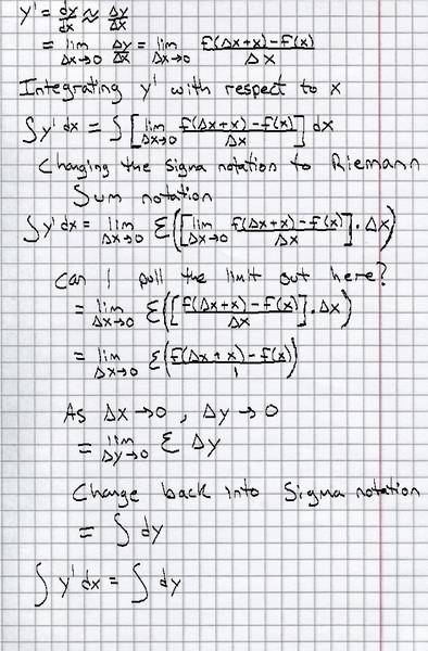

I'm not entirely sure on the properties of limits, but this seems to work. Could someone look over this for me?
http://imgur.com/6zCHYo5

What is it that you're trying to do?
Please state the problem.

Not really a problem here, just wanting to make sure I'm doing this correctly. I'm trying to show that ∫ y' dx = ∫ dy through definitions.
What are you using for the definition of the indefinite integral?
The Riemann sum is generally used for the definite integral.
