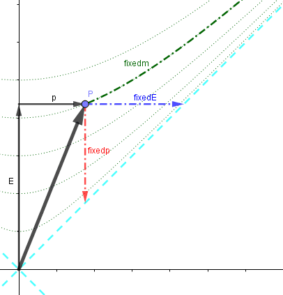

With regards to limits,
the diagram below from this old post ( https://www.physicsforums.com/threads/massless-photon.900960/post-5842652 ) might be useful
(an extension of this diagram is here:
https://physics.stackexchange.com/a/551250/148184 )
