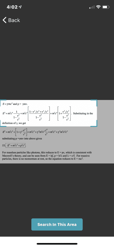

This is not allowed per the PF rules. Please use the PF LaTeX feature to enter equations directly in the post. A link to the LaTeX Guide is at the lower left of the post window.
Then this disqualifies me from using the forum. I am legally blind, and use of LaTex is beyond my ability. (I installed it on my mac, and see that it is beyond me.) The keystrokes are just too difficult. I am able to use MathType, but you guys do not recognize that apparently. Maybe I can find another forum which allows screenshots of written text I prepare on an ipad.
Just to clarify why we normally don't allow equations in images, it's because there is no way to quote the individual equations in responses. However, given your particular situation, we can do our best to work with whatever you can give us.
You mentioned MathType; is that what you are using on your ipad to prepare equations? It's possible that there is a way to translate that to LaTeX.

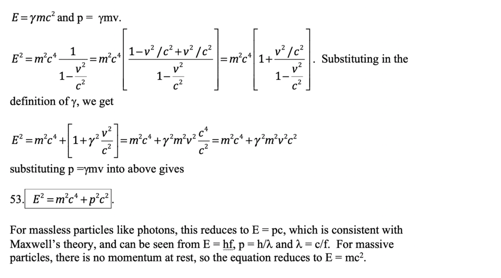

Off-topic but Possibly useful:
https://math.microsoft.com/en
Not perfect... but...
Produced from ocr on an image
https://www.physicsforums.com/threads/e-pc-derivation.997649/#lg=post-6435618&slide=0
saved to my phone. I did not edit the LaTeX produced.
Code:
\left. \begin{cases} { E = \gamma m { c }^{ 2 } } \\ { p = \gamma mv } \end{cases} \right.
From a screenshot of a desktop screen with my iphone camera,
I got [without editing the LaTeX produced]
Code:
\left. \begin{array} { l } { E = \gamma m c ^ { 2 } \text { and } p = \gamma mv } \\ { E ^ { 2 } = m ^ { 2 } c ^ { 4 } \frac { 1 } { 1 - \frac { v ^ { 2 } } { c ^ { 2 } } } = m ^ { 2 } c ^ { 4 } [ \frac { 1 - v ^ { 2 } / c ^ { 2 } + v ^ { 2 } / c ^ { 2 } } { 1 - \frac { v ^ { 2 } } { c ^ { 2 } } } ] = } \end{array} \right.

john t said:
Can one say that my logic shows the consistency of the specific with the general equation
I think you could derive an equation, that is also valid for photons, by avoiding ##\gamma## as a factor, with ##m## being the "invariant mass", which is defined, but zero for photons:
$$mc^2 = E \sqrt {1-\frac{v^2} {c^2} } \ \ \ \ \ \ and \ \ \ \ \ \ \vec p = \frac {E} {c^2} \vec v$$
$$m^2c^4 = E^2 (1-\frac{v^2} {c^2} ) = E^2 - p^2c^2$$
Update: Repetition of my LaTex-formulas as text, so that a text-to-speech software (for example Windows 10 Narrator) can read it (symbol by symbol after cursor-movements):
mc²=E √(1-v²/c²) and p=E/c² v,
m²c⁴=E² (1-v²/c²)=E²-p²c²
