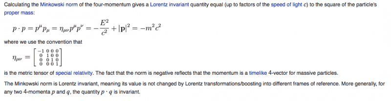

I have attached a derivation of the Minkowski norm of the four-momentum but just don't quite see how the writer arrived at ## -m^2 c^2 ## from what was given. How exactly does this quantity follow from ## -\frac {E^2}{c^2} + p^2##? I feel like it might be very obvious, so any explanation would be great!

I would say that it is a definition rather than a derivation. We use the norm of the four momentum often enough that it deserves a name, so we define the name "mass" to refer to it.
