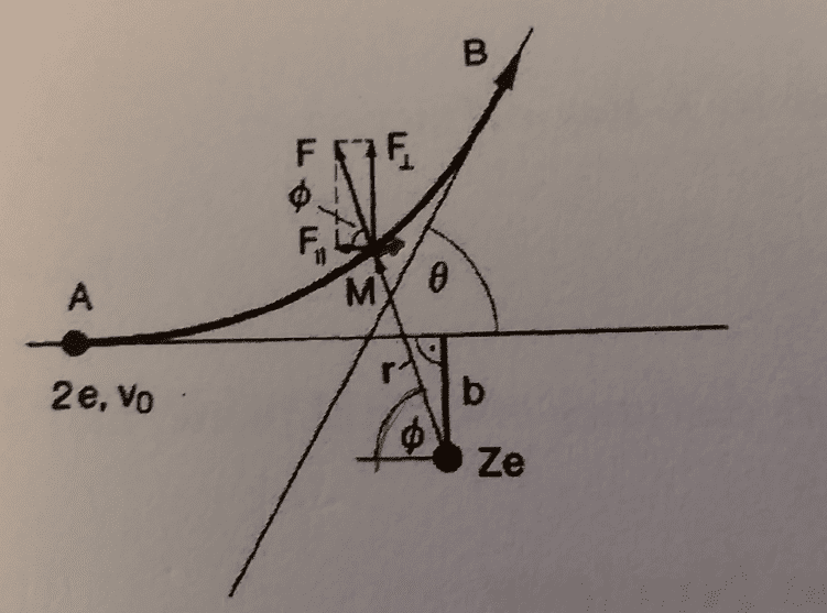

I am trying to show that as the alpha particle is being scattered, the angular momentum magnitude at point M is [itex]m r^2 \frac{d \phi}{dt}[/itex].
Diagram:
Diagram of Rutherford scattering: alpha particle (2e, v0) travels along a curved path from A to B past a nucleus Ze, with impact parameter b, angle theta, and force F resolved into components F-perp and F-parallel at point M.

Most derivations of this I've found online seem to glaze over the determination of angular momentum at point M, making me think I've missed something simple. Could anyone point me toward a better approach?
  • Lecture slide titled The angular momentum showing L = r x p = m r^2 dphi/dt as equations (5), with a diagram of an alpha particle path scattering off a nucleus at the origin, marked Scatterer, with impact parameter b, angle phi and positive phi direction.

The angular momentum is ##L=\vec L = \vec r \times \vec p ##.
Is M the point of closest approach?
The momentum ,##vec p = m \vec v. In polar system of coordinates, the velocity has a radial component and a transversal one. See http://pioneer.netserv.chula.ac.th/~anopdana/211/24rtheta.pdf The vector product with the radial component is zero. The transversal component of the velocity is r dφ/dt. It is easy to get angular momentum from here.
