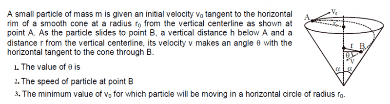

Deriving Angular Momentum in a Particle Inside a Cone Problem
47 replies · 6K views · last reply
Tanya Sharma
1,541
135
Diagram of a particle on the smooth inner surface of an inverted cone, with labeled points A and B, velocity v0 tangent at A, radius r0, height h, radius r, velocity v at angle theta, and cone half-angle alpha, plus three numbered questions.
The only thing I can think of in this problem is energy conservation .
##\frac{1}{2}mv^2_0 = mgh+\frac{1}{2}mv^2##
Not sure how to proceed . I would be grateful if somebody could help me with the problem .

Energy conservation is a good start. What does it tell you about the particle at point B?
What else could be conserved?
It gives us the speed of particle at B . I should have mentioned in the OP that I did managed to get part 2 from energy conservation . I was thinking about part 1 of the question .
I had thought about it , but can't think of one .
Which conservation laws do you know in general?
The speed is also relevant for part 1.
Energy conservation , Linear Momentum conservation ,Angular Momentum conservation .
Linear momentum can not be conserved for sure . So,I am guessing it has to be angular momentum . But the two forces acting on the particle , Normal and the Weight seem to have a torque about the center of the circle ( if I choose center as the reference point ) , in which case angular momentum cannot be conserved .
Torque is a vector quantity. Is there any direction in space such that the net torque always has zero component along that direction?

The key thing that the analysis delivered was that angular momentum around the axis of the cone is conserved.
Exactly. All forces are in radial or vertical direction, never "around the axis".
There is no need to solve anything time-dependent, however. We know the total speed, and we can calculate the (edit) tangential component using angular momentum conservation.

Since the net force on the particle is down the slope towards the apex of the cone ,the net torque about the apex would be zero . Right ?
So, we need to conserve angular momentum about the apex .
Should the angular momentum of the particle at t=0 be ##mv_0l## ,where ##l## is the slant length of the cone . Since ##l=\frac{r_o}{sin\alpha}## , initial angular momentum = ##\frac{mv_0r_o}{sin\alpha}## . Is that correct ?
I would like to admit that I am finding a bit difficult dealing with directions in this problem .

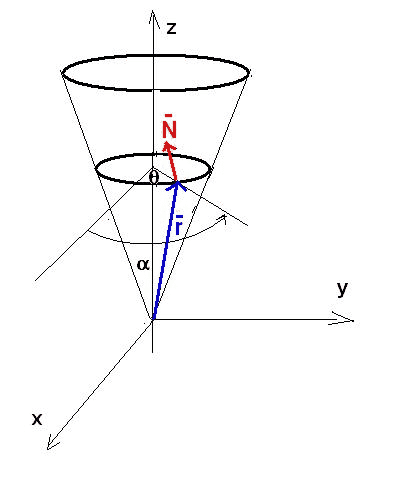

Which component does not contribute to the angular momentum?
Diagram of a particle on the inner surface of a cone opening upward along the z axis, with the position vector r and normal force N drawn from the apex, angle alpha marked at the apex, and x, y, z axes shown.
You see that the normal force N has vertical component, but it does not contribute to the torque about the z axis. The horizontal component (in the horizontal plane shown) of N is radial, points to the central axis. Does it have torque about z?
Gravity is vertical, which does not contribute to the z component of the torque, either.
By vertical component , you mean along the z - axis ?
By horizontal plane , you mean x-y plane ?
What does ##\theta## represent in your diagram ?
Yes.
Yes.
It is the angle the horizontal projection of ##\vec r ## makes with the x-axis (think of the spherical coordinates) . The horizontal projection of N encloses the same angle with the x axis.
Make a paper cone and see (or perhaps there is a funnel in the kitchen :) )
Okay , so now my first step should be to write out the position vector of a point of the cone with its x,y,z components, taking the angle alpha into account . Right ?
Both angles, alpha and theta.
Yes, do it, calculate the components of the torque, using the components of the position vector and those of the normal force (and gravity). It will convince you fully.
