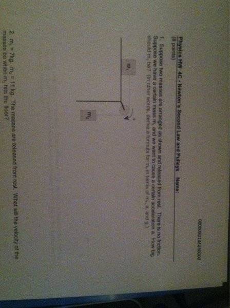

1. Suppose two masses are arranged as shown and released from rest. There is no friction.
Suppose we have a certain mass m1
and we want to cause a certain acceleration a. How big
should m2be? (In other words, derive a formula for m2in terms of m1, a, and g.)

I completely neglected the diagram when I posted this! I'll go to mobile and attach it and then perhaps this will be easier. I can't read the last LaTex equation, is that on my end or yours?
Thanks so much. :smile:
SteamKing, I think I see what you mean with the equation. When I typed it I must have done something wrong with LaTex. Thanks!
Here we are. Can you see the diagram and the question easily? The problem I'm on right now is the first.
Thanks again!

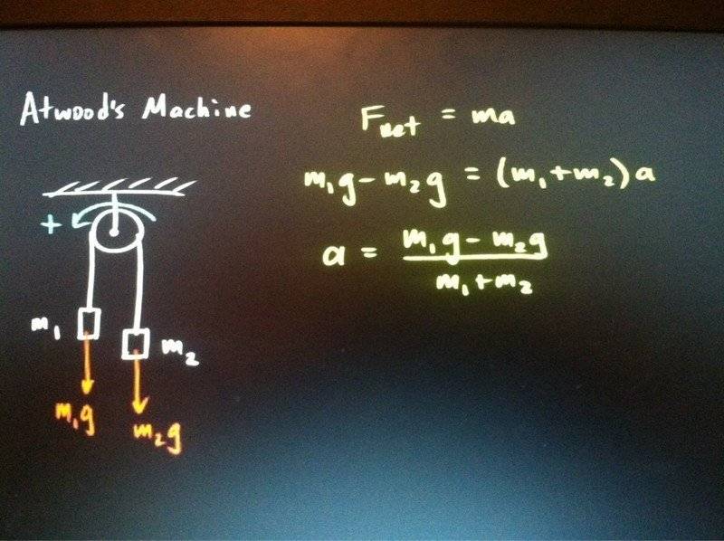

Sorry about the pic, maybe I can figure out how to take it better next time. The equation I used is the root of the problem. I clicked on a video and watched my teacher use the equation that I will attach. I forgot that that video was part of a series, and he said that that equation was for one specific situation. I will rewatch the video and get back to this thread tomorrow, thank you all for pointing out that the equation was wrong for this situation.
Medgirl314 said:
Sorry about the pic, maybe I can figure out how to take it better next time. The equation I used is the root of the problem. I clicked on a video and watched my teacher use the equation that I will attach. I forgot that that video was part of a series, and he said that that equation was for one specific situation. I will rewatch the video and get back to this thread tomorrow, thank you all for pointing out that the equation was wrong for this situation. View attachment 65629
Yes, it's wrong. Atwood's machine has both masses hanging. You have one mass on a horizontal frictionless surface. There are ways to derive these on your own. Use the notion of 'tension'.

the pic in post #7 is called "Fletcher's Trolley". a hanging mass propels itself and the trolley.
the pic in post #9 is called "Atwood's machine" either way:
Easy way: treat the pulley as a "bend" in the coordinate along the string
left side: How much external Force is there (total), along the string?
right side: how much mass is there (total) that needs to be accelerated?

in post #7's pic, block m1 slides along a frictionless table toward the pulley
m1 can be set on wheels, to approximate frictionless motion, if you want to actually do this experiment.
Atwood's machine acceleration is fully solved on post #9's pic (but not the rope Tension)
this approach looks at the unbalanced Forces pulling leftward (ccw) or rightward (clockwise) ... not up and down.
Oh, so it wasn't a literal trolley. Okay, makes sense.
I'm somewhat confused by the last sentence. Is there a way to derive this particular equation algebraically, or do we need to make inferences based on the picture?
Do you see in post #9's pic, how the Forces are drawn?
the weight on the right tries to turns the system rightward (clockwise),
the weight on the left tries to turn the system leftward (ccw):
the total rightward Force is : m_right g - m_left g ... that is what Sum Forces means
... which the pic writes as "net Force" , which means all F's added up, sign-wise.
Using that Atwood as a pattern, can you do it for Fletcher in post #7?
