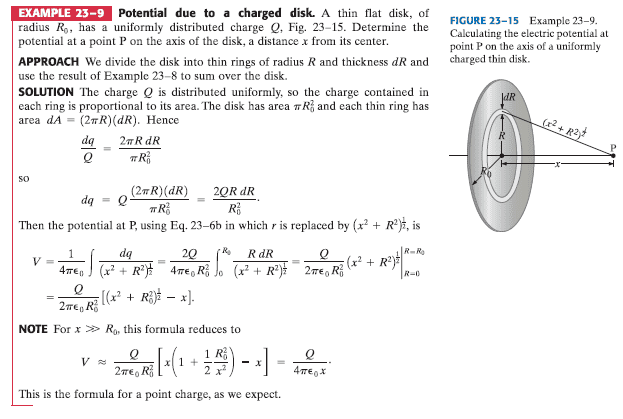

How was the equation for area of a ring derived?
  • Textbook page, Example 23-9, deriving the potential at an axial point due to a uniformly charged disk by summing thin rings, with a labelled ring diagram and the integral for V.
I can derive the area as the difference of the areas of two circles. ##= \pi(R+dR)^2 - \pi R^2##
But I don't think this ##\pi (R+dR)^2 - \pi R^2## is equal to ## (2/pi R)(dR)## given in the beginning.
No, but it's an approximation for small ##dR##.
When setting up integrals, the differential is assumed to be vanishing small, so that terms proportional to the powers of the differential can be neglected.
