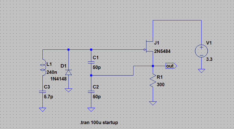

hi , i want to design a clapp oscillator with output frequency up to 150 MHZ , inductance value must be 0.24 u , who can help me please?? i need it for my project

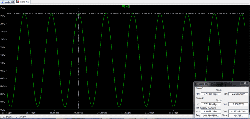

here is my oscillator design , the output frequency must be 150 MHZ but the simulation in ltspice is 147 MHZ

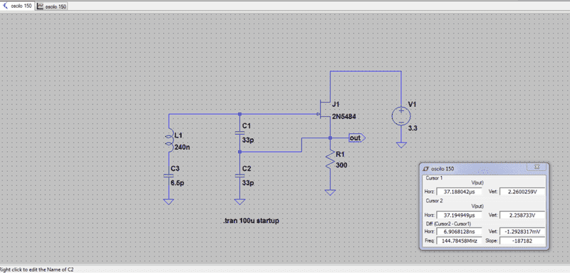

i tried your option but i found 144 MHZ
sooo ... did you think of trying other values ??
start thinking about the problem
so if you went to 33p and the freq dropped, what do you think that is telling you ?
what should you try next ?

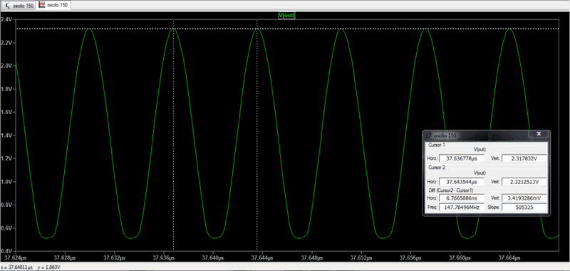

I Tried with c1=c2 = 50 pF and C3 = 5.5 pF i found 150 MHZ :) but when i calculated i found 153 MHZ !

The LTspice circuit shown in post #4 has D1 as a bias or limiter component, but D1 is the wrong way round to DC bias an N-JFET.
In post #9 the diode has gone, but there is still no gate DC bias.
You need to DC bias the gate by replacing D1 with a 47k resistor between ground and JFET gate.

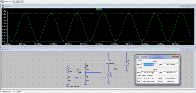

hi everybody , i replaced the diode with a bias resistor as Baluncore said , but i found 147 MHZ , should i add a temperature compensation to my circuit ?
do you see the frequency changing with temperature ?you haven't tried my other suggestions yet

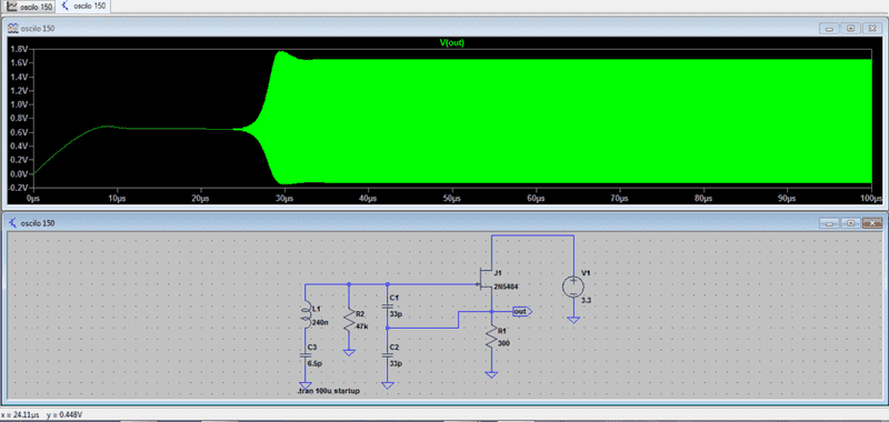

i Tried with c1=c2= 33p and c3 = 6pf , i find 150 Mhz with a bias resistor of 47k :) thank you all :)
You are only specifying capacitors to two digits, while the real ones will probably have a 5% tolerance, so why do you worry about a 2% difference between the crudely predicted frequency and the LTspice simulated frequency. Once you build a VHF circuit on a PCB it will change again and you will need to trim the frequency with a variable capacitor. It is a mistake to fine tune a simulation beyond what is sensible.
When measuring time and frequency, do not use the poorly defined flat part at the top of a sine wave, use two cursors and place them at the same voltage on the steepest part of the wave form. That will be much more accurate.
Select the plot window then 'view' FFT, to get a better estimate of frequency and see the harmonic distortion of the oscillator.
Change the FFT frequency axis to linear and use dB for the vertical axis.
Rather than fine tuning frequency, play with the model to find the extreme component values that will still oscillate reliably.
You can then manufacture a very reliable product by using values that lead to stability.
You might try changing the source resistor to change the JFET operating point, which should reduce power consumption and maybe change the output voltage range relative to zero.
You might try changing the 33pF capacitors and 47k bias resistor to get a faster more reliable start-up of oscillation.
LTspice has a temperature step command so you can check semiconductor temperature variations.
Paste the command .Step Temp 0 40 10 onto your circuit schematic using the .command text button on the RHS of the toolbar.
