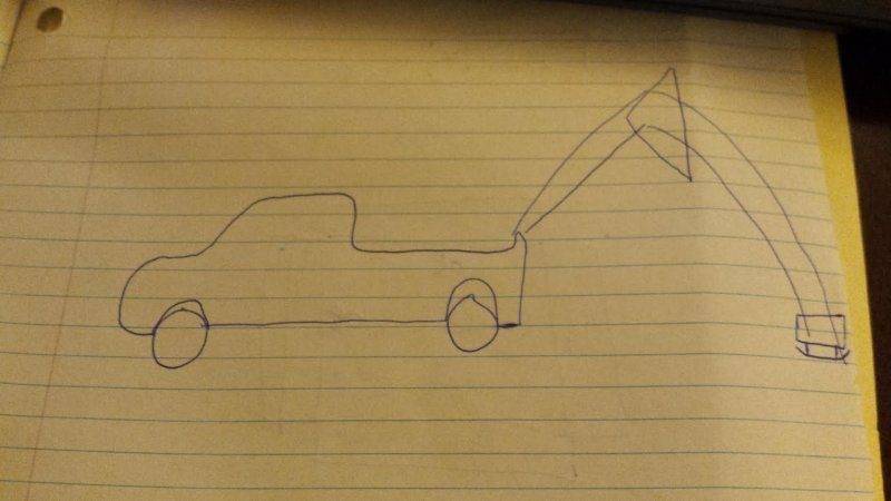

I am embarking on a drive to the arctic circle. I have spent a bit of time googling looking for a kite to pull behind my truck to film the adventure and can't find much useful information.
Is there anyone that could design or point me in the direction of a place to design a decent kite to pull behind( and above) my truck with a ~2kg camera lens. Maybe a little extra payload to accommodate a gimbal.
Well 2 kg is actually quite a decent payload for a (relatively) small kite, but the main problem here would be stability, because the towing vehicle generates considerable vortices. Thus the kite will have to fly quite high above and far behind the car, which means every gust of wind will move it so far sideways that it might be difficult to keep the camera on the car (if you want to film the car).
If you just want to film the surrounding scenery, sideways movement is not problematic, but you’ll still need automatic stabilization of the camera, because there will be a lot of shaking.Another problem is getting the kite in the air. You will need someone to help you with that when there will not be enough wind.The last problem is landing the kite safely – without breaking the kite or the camera, and without it hitting the car.
So preferably you would need some means to control the kite, thus my bet would be to go with a more rigid structure – a glider (with rc). This would also eliminate the takeoff and landing problems.If you give more specific demands (video quality, size, weight, complexity, price), you can get better answers.
Flying high above the vehicle is what I am looking for. I guess, how high above should be determined by vortices perhaps as you say they are a considerable problem. This will help determine the lens and camera that I use.
I never considered vortices so that is valuable information to think about while flying whatever I finally end up with. On the ice road there should be semi trucks that will be coming from the other direction that will have an even larger effect than my own truck.
The idea of the kite is to get a wide angle video of the truck with the surroundings as it is driving.
I will mount a gimble on the kite which will allow the camera to stay level and properly oriented even if the kite pitches and rolls. It will also have rc to alow to control of the camera orientation
A glider is probably more what I was thinking too. I imagine a wing with skis on it for takeoff and landing. Pulled by 2 (or more) cables that are on either side of the wing to help keep it centered behind the truck.
One Idea that I have that may help stability is if the towing cables actually continue past the glider to a sled that stays on the ground underneath and behind the truck. This might allow me to control the height of the glider by changing my vehicles speed.
I would probably like to be traveling around 40km/h to 60 or 80.

Why not use a radio controlled model (electric motor so cold isn't a problem)? For 40 to 80 kph, some type of aircraft as opposed to a multi-rotor would probably be better. To make it simpler to fly, you could also consider using a 3 axis gyro so that the model is self stabilizing.
I was thinking something that is pulled with cables from the truck would be better because it would only require one operator, just for controlling the camera Gimbal. Also I thought it should be a little cheaper...
One issue is trying to make a glider that is stable while being towed at 40 to 80 kph, and you'll need an operator and/or 3 axis gyro to keep the glider stable and an operator for the camera.
What would the the person operating the glider be doing? Are you saying that it wouldn't be possible to have a glider that stays on course by itself? Thanks

Also, we could look at our aircraft as a pendulum (since it will naturally sway in a similar manner).
If the camera is self stabilized, the sideways and the vertical movement will not bother us much, thus we only need to limit the swaying motion, not prevent it completely.
As the car will accelerate and the planes altitude increases, the downward force (due to the tether) will increase, thus limit the max altitude. As long as the horizontal and vertical stabilizers are effective enough the swaying should not be a problem. And sufficient roll stability could be achieved by a high wing back-sweep.
What needs to be done is something like the Argo (row), or a towed sonar, except that we want it to fly.
http://www.naval-technology.com/contractor_images/6831/images/99900/large/1.jpg
It’s doable without the need for an operator (provided ±10° sway is permisable), the only problem is with the landing.
10° of sway should be fine, the gimbal will be able to handle that much.

Before rc transmitters were widely available, people used to fly powered airplanes that had several tethers by which they were controlled much as kites are. The default mode of such a plane was to circle above the person controlling it (it could circle stably without any input from the controller). This could be adapted for when you are traveling at low speeds, however achieving stabile circling might be difficult due to the forward motion. Check the history of model planes, perhaps it yields something useful to you.
Most available rc aircrafts don’t have a high enough payload capability, thus it will probably have to be built from scratch. The plane itself should be quite cheap and easy to build, however I don’t think it’s design is that straightforward, it would require a few calculations and a test or two.

I think a tapered delta design with a couple of skis for take off and landing is what I should go with. I'll try for a 2.5m^2 Like you're saying strive. I should be able to get something like that built pretty quickly.
The necessary wing surface area depends on the wing geometry and the chosen airfoil.
Which airfoil have you chosen?
You will need a very effective tail section.
Which geometry and airfoil have you chosen for it?
